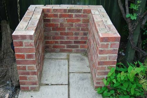

We have a pizza oven that we bought from Bunnings years ago, but it stands on metal legs. We want to change the base so we can store wood for both our pizza oven and fire pit in. We have decided to build it from Besser blocks and our going with an easy structure, similar to a horse shoe (but with square corners). Our biggest problem is trying to build the top so the pizza oven can be placed on top. We are looking for something premade that can be bought from Bunnings. Research has shown us Hebel sheets, but I’m a bit worried that won’t work and hold the weight of the oven. Our dimensions are 1m x 1m. Is there other suggestions? How difficult is it to build a concrete top? Not our photo, but an example of the shape we think we will use.
