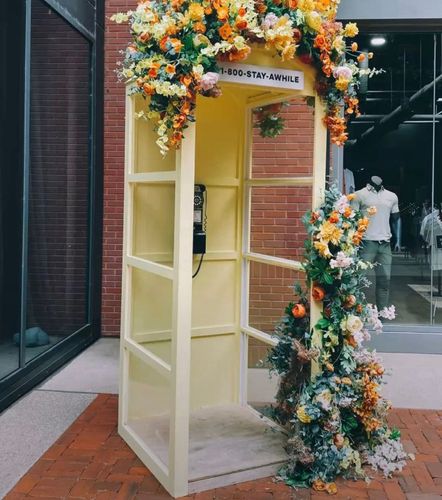

I realised I’ve said “Photo Booth” I meant phone booth. No one will be going inside it and the phone  that will be attached will be a prop. I’m mainly making it to show case my floristry skills for a final piece. Something like this image.
It will be inside, no budget but to keep it as cheap as possible.

hahahahah :laugh: Well the three panel idea still works, just different support instead of diagonal truss you have  four horizontals. The rear panel can be something like this 2440 x 1220mm 3mm Plywood Pine Premium BC Grade (mostly for the lightness in weight) and as soon as its screwed to that back plane it will lock it steady.

For your project, I would suggest using 42 x19mm, 89 x 19mm and 140 x19mm DAR Pine timber. You'll also need a plywood or MDF board for the roof and base. I've created a rendering for you below, which should help with the assembly.
If you were going to paint the unit, you could potentially make the sides from MDF board and cut out the windows from it. So, instead of assembling all the individual timbers for the sides, you'd just cut rectangles out of the board to imitate that look.
