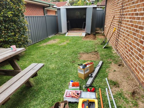

The ground is undulating and I have approx 190mm to work with as my finished height. I would like to build it without using footings and use the plastic toughblock or concrete blocks so the deck is floating and removable as there is plumbing that may need access by council. I was thinking of using 140x45 timbers joists using the plastic toughblock. Or the 90x45 using the concrete blocks?
Any advice would be appreciated as I don't want it to be spongy under foot.
Is this possible? Any advice is appreciated.

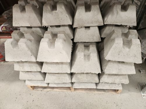

Let's do some quick math, if you have 190mm of space to use, the DEKO 250 x 150 x 150mm Instant Concrete Foundation Block will provide 110mm of height. If you include the 90 x 45mm Outdoor Framing MGP10 H3 Treated Pine - 2.4m and the standard Merbau decking panel thickness of 19mm, you'll have a total of 174mm. This means that you'll need to add 16mm of soil beneath it to have it at exactly 190mm.
