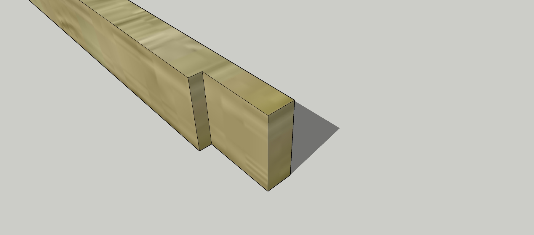

Can I please ask one more question. If we attach the horizontal support to the top, screwing it into to the vertical posts, it will create a small gap between the fence top and the wooden support due to the ridges (as in the photo attached). Do you think we need to attach it to the top as well and get longer screws (the danger of the fence flexing), or putting some washers between the fence and the wood? Or is it enough to attach it to the vertical posts only (2.4 m apart)? Thank you for your advice. PXL_20250429_015439973.jpg

I propose rebating the ends of the timber so that it will sit snugly on the surface of the fence rail. It can easily be done with a hand saw and you won't have to bother with washers or spacers. I've placed a sample image below to give you an idea of what you'll need to do. It would be better to attach the support piece along the length of the fence as the Merbau panel does have a bit of weight to it.
Re: How to attach SpecRite 1800 x 902mm Pre-Oiled Merbau Panel to existing Colourbond fence?
Thank you. That sounds like a much better solution. Much appreciated.
