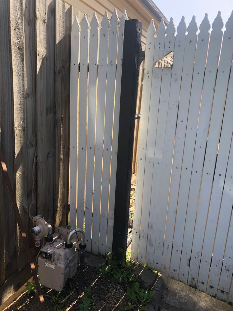

I have a Picket gate where the non-hinged post could use greater support. It's the latching side and appears to not have been driven deeply enough into its hole. While it's in no danger of falling down it could use greater support and while digging the post out and re-tamping or adding concrete would be the best option I am wondering if there are any other options that I could explore.

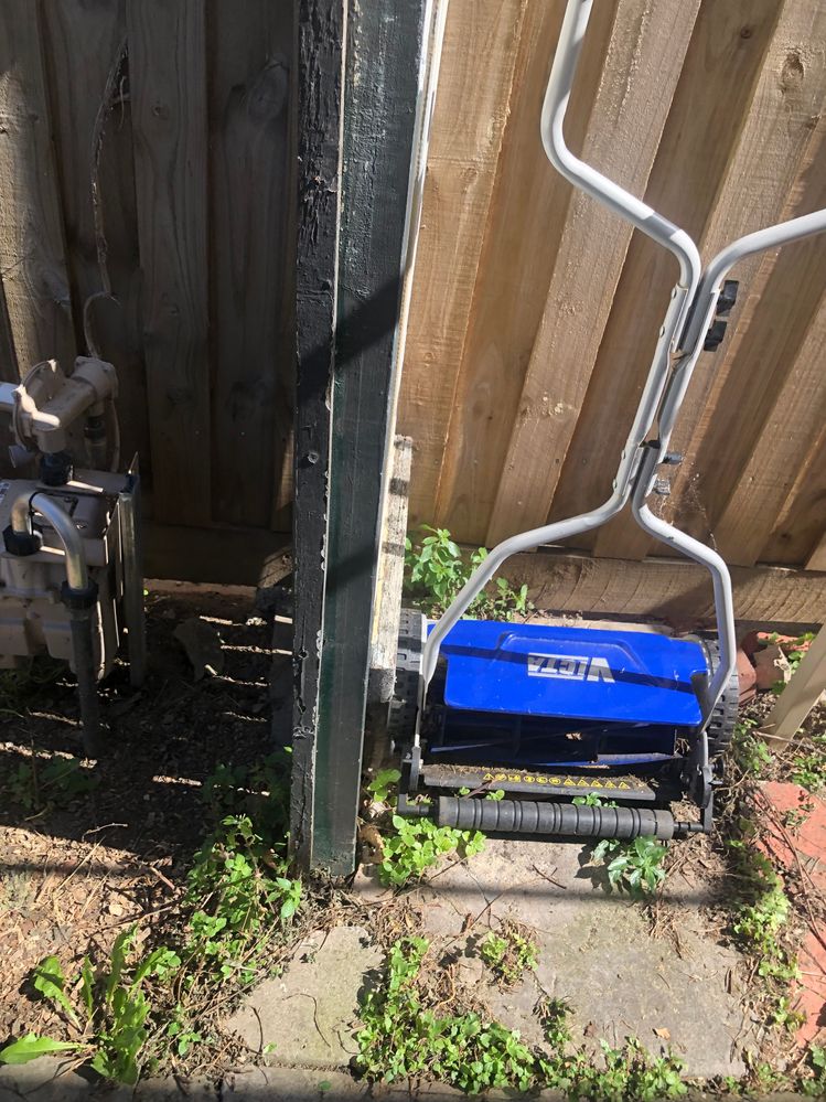

Thanks guys for the suggestions. Here are some photos. I'm pretty sure the post isn't buried too deep in the ground and there are pipes near the base which limited how far we could dig. IMG-0934.jpgIMG-0935.jpg

Thanks for posting those extra photos of your post. I would hold off digging in that area as there is a gas meter right next to the post. If you can't dig down, I suggest building square formwork around the post and filling it with concrete to create an above ground footing. this should provide extra support for your post.

Thanks very much Eric I'll look up how to do this.

Apart from the footer and the connection to the ground, you might like to check how well that panel is connected to the fence. It appears that the fence was replaced somewhat recently, and I wonder whether the panel was re-attached in a strong enough fashion. I'd recommend locating the horizontal fence rails, which you'll be able to detect from the pailing fixings. Adding a couple of heavy-duty angle brackets fixed into the fence rails and then into the panel will go a long way to shoring up the fence post.

You have good eyes Mitch! The panel is attached to the rail with some skewed screwing, it's not sufficient and I like your idea of L brackets.

In that case, I'd recommend those brackets to try and stabilise the top of the panel/post. You can then look to see if work will also need to be done on the footer.
