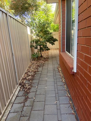

How do I paint a metal fence?
My fence is currently an ugly beige colour and I am looking to paint it a dark grey.
Preferably without purchasing an expensive paint sprayer.
Photo of the fence for reference
Thanks!

I'd advise looking at the Dulux Weathershield range of products. They come in different levels of sheen and can be tinted to many colours depending on your preference.
Make sure you prepare the surface well, by cleaning it with Selleys Sugar Soap and then priming with Dulux Precision 1L All Metal Primer.
While not necessary to use a paint sprayer, they will give a cleaner look when compared to a brushed or rolled finish, so it is worth considering a reasonable priced paint sprayer such as the Wagner W125 Wood & Metal Paint Sprayer.
If you were to use a brush or roller, I would advise getting one of a good quality such as Monarch Expertech 100mm Nytec Wall Paint Brush or Monarch Expertech 75mm Walls And Ceilings Spi-Weave Roller Cover and the accompanying roller.
It would also be beneficial to add some Flood 1L Acrylic Paint Conditioner following all instructions on the packaging as it will help to smooth the paint and allow for a cleaner finish when using the brush or roller.

Applying the products @JacobZ has mentioned through a paint sprayer would be an option, but the area is far too large to use spray paint in pressure cans.
