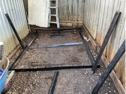

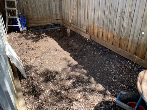

Hello,
We want to put a spa in here, behind our shed (ignore the crazy steel).

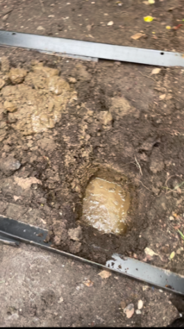

I have dug down 300mm and hit water (nieghbours on both sides have slabs and pounded blue metal.
How do i make a stable place to put 600x600 concrete pavers on which to then put a blow up spa (around 1000L).
Do i dig down 200mm, put a timber border, fill that with stones, then put geotextile, then put sand, then put concrete pavers on top of the sand?
The area i'd like to pave is 3m x 2m but i'm mostly concerned with how sloppy the ground is.
I want to avoid putting in full-on drainage.
Thanks,
