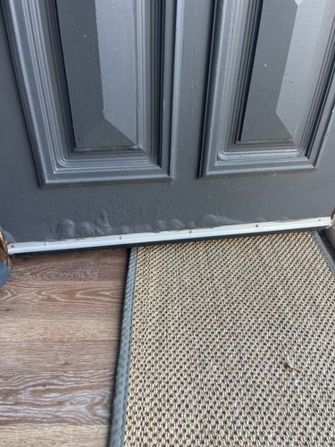

When it rains heavily or the rain hits directly onto our front door, water seeps in through the corners and edge of the door onto our floor inside. There is a seal against the door but water still trickles in. It’s damaged our vinyl flooring!

If the doors of the interior frames lip are still in good condition, I suggest using Moroday Grey Self Adhesive Weather Seal. To prevent further incursions of water under your door, I suggest using Raven 920mm Clear Anodised RP3 Door Bottom Seal.

Please consder re painting the door as you can see the paint bubbling lower down. To real problem is painters never paint underneath the door edge or often on top too thats a water ingress point to your timber and will cause your door to rot prematurly .
Also maybe you can some how screen the front door from your most prevailing worst weather. Or a over head extention to your eve near the door if the rain problem persists. A simple pull down blind will work to help shield your door way in the worst conditions.
If the water is flowing towards your door on the ground maybe it can be diverted away.
