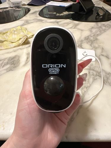

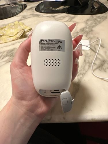

We recently changed wifi networks and have been reconnecting our smart home accessories (realised too late we could just change the new wifi name/password to the old one). We’ve successfully done it with everything except one of the grid connect (orion?) security cameras. For some reason we cannot reset it and the pin goes way further in than it should. I’m planning to take it apart so i can see if there’s an issue with the reset button but I can’t figure out how to get to it. I’m open to suggestions aside from opening it too.

As this camera is IP65-rated to allow its use in outdoor areas where it is exposed to water, it is likely a fully sealed product that is not able to be opened.
You might be able to use some thin wire such as this Jack 0.70mm x 75m Wirepak Galvanised Tie Wire to press the reset button, but this would be a case of trial and error.

I  would look up product you tubes to find out how to access the reset pin there may be a trick to it.  Sticking a  metal pin into it to deep at the wrong angle may short the unit out and kill it probably a  20% chance of that take a little care here.
Pulling those cases off often means  prying the case to pop hidden plastic latches there is a high chance it will be damaged and not be water tight (weather resistant in future)  Some times  screws are hidden underneath stickers and or plastic flaps too.

Trying to find the reset pin can be a pain... A real pain but I havnt had too many fail on me. What are you using for a reset pin? I use a sttraightened 50mm (large) paper clip. With the power off from the unit can you sit there and gently poke and feel it hit anything? Id try a few of those type of experiments before going down the route of trying to open it up. If you do manage to feel the button (you should be able to feel a difference as it switches) then power it back on and try to reset it. The instrcuctions I saw said it had to be depressed for 5 seconds.
If you exhaust the feely solition :smile: And want to resort to using a more effictive hammer style action, I would go down the route of a thin but blunt butter knife. From your two picures I cant determine if it clips together in the center or its smooth everywhere except the black front. If its the black front as the only change from that plastic then using the tip of the rounded butter knife (not a stanley as it will mark the plastic easier) try running it around the edge of the black and slightly pushing into and twist. (make sure its disconnected first :smile: )

we were using the pin that comes with iphones to remove the sim card slot which worked fine for the other camera. when it didn’t work for this camera (they’re the same camera bought at the same time) we tried using a safety pin but it went in way deeper than it should’ve without being able to feel the button. my idea to open it up came from my thinking the reset button had moved and i might be able to find it and press it that way.
