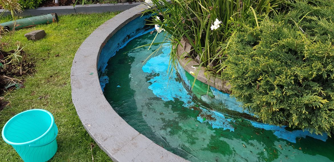

I am looking for ideas on how should I fill up the garden pond that I recently got emptied. I do not wish to pump water in and out anymore. So I am planning to fill it up with something to make it look good and easy to maintain.
The ideas that I have toyed with are:
- Concrete and pebble mosaic - never done anything like this before.
- Convert it to veggie patch - The pond base is quite hard (probably concrete?) so not sure if this will work if I fill it up with soil.
- Fill it up with pebbles - Worried that rainwater may collect below the pebbles and then cause issues. - I want to do this as it is the easiest but do not know how to make sure that water does not collect. Any tips?
You can look at uploaded photo to give any ideas that you all can.

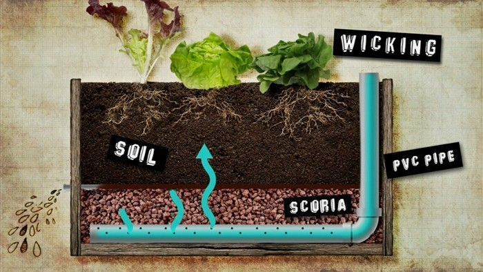

If you want a garden or vegie bed you could convert it into a "wicking garden bed" (google it) and then you would only need an overflow pipe/hole so it does not get waterlogged.

Back in the real world, I think a wicking garden bed is an excellent idea, and there's bound to be a YouTube video to match your level of interest.... from just the basics to full production aquaponic systems. http://bit.ly/38PJgnW
Re: Empty pond - Fill up
Thats a great idea. I already have a PVC pipe that may have been used by the previous owner to setup the same. I could re-purpose it to convert it into a patch. Thanks for that.

My advice would be, if you don't want to use this structure as a pond anymore, get a masonry drill with either a large bit or a core-bit on it and drill through the concrete at the low point of the pond and a few other points around that.
That way it will drain, should it rain.
If you installed some fine mesh on rebar chairs and installed some low voltage uplighter lights, in the mesh and then installed some coarse stones/rocks around them light fittings.
This is only a ball-park thought on my part, before you do anything, you need to take to that pond with a water-blaster.

That seems like a brilliant idea. Since I have shrubs in the middle, uplighter lights can create a brilliant ambience in the garden. Thanks for that idea. I will see if I can put that into action.
