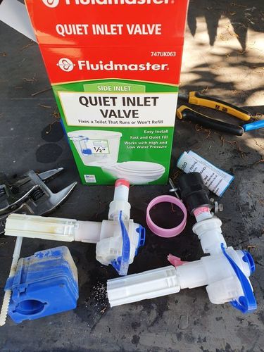

Unfortunately, the air-conditioning unit died around 1600 hrs yesterday - and it took a little time to get on the roof and into the unit to diagnose the problem. Bad time of the year to happen.
I felt it was the drop-valve.
On the ground, I rang the air-conditioning firm I always ring for spares/advice and was told they had a replacement valve. But it was 1645 hrs and "we close at 1700hrs, reopen at 0900 hrs tomorrow."
Me - "Cost?"
Reply - "$87 plus GST."

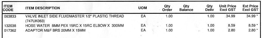

I took the old parts to a plumbing store at 0800 hrs this morning. Not expecting any luck, as I always thought the drop valve was a specific air-conditioning unit part, I felt really stupid when he put it all together for around $50. I had the unit running in less than an hour.
I learn a very valuable lesson today. ![]()
Proof they were trying to sell me the same $34 valve for $87.

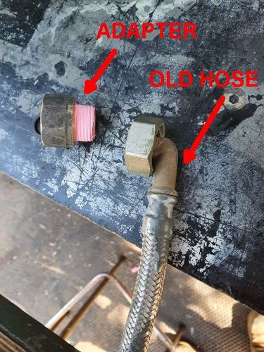

This the "before" photo.
Next time things fail - I'm gonna put a longer "Kinetic Connector" hose on and bypass that solenoid valve (indicated) - going straight to the drop valve. Both now being 15mm fittings.
Should work?

Hi @Noyade
The solenoid serves as an electro-mechanical stop. It might be an emergency stop or serve as a backup to the fluid master. Either way, it's best to ask an air-con specialist if it's safe to do a direct connection.
