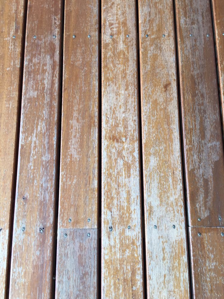

I thought my deck experience might prove a handy reference for many on here. Our deck was about 5 years old and ready for re-oiling - after earlier failed attempts I knew that a total strip and sand would be necessary to get the best result.
This was the original state, clearly in need of some attention.

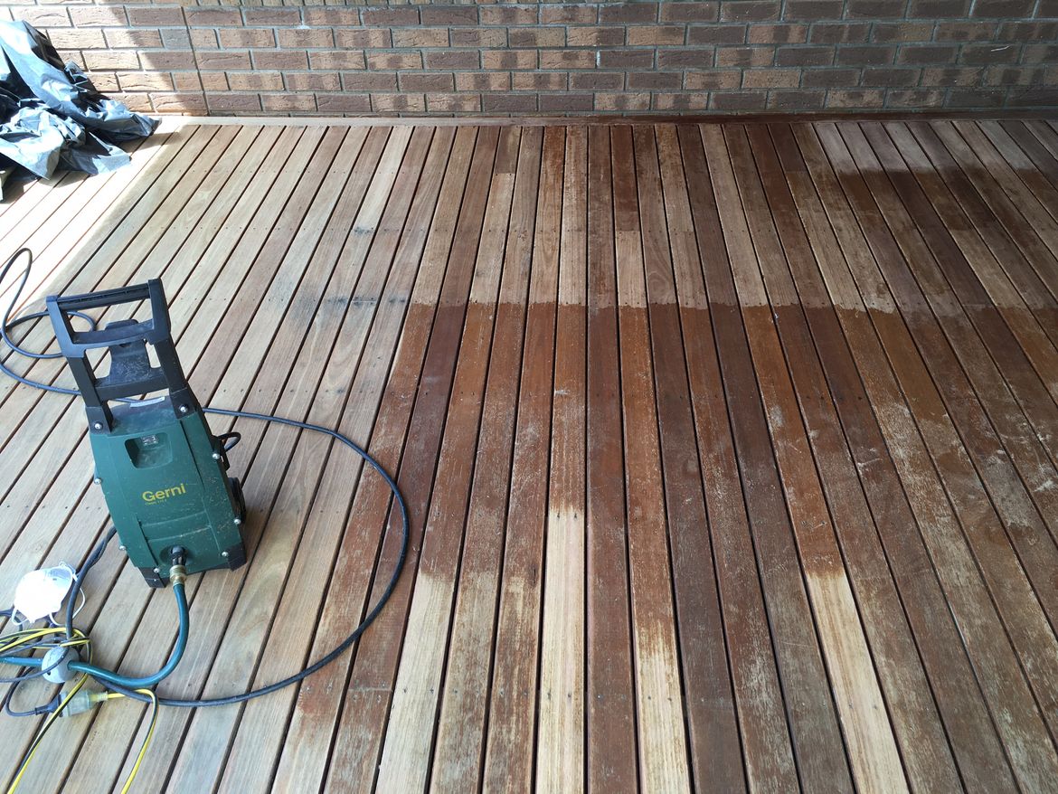

Initially I resorted to using Power Prep and the pressure sprayer, which wasn't quite enough for stripping back of the existing deck finish. Here is one of the initial stages of using Power Prep.

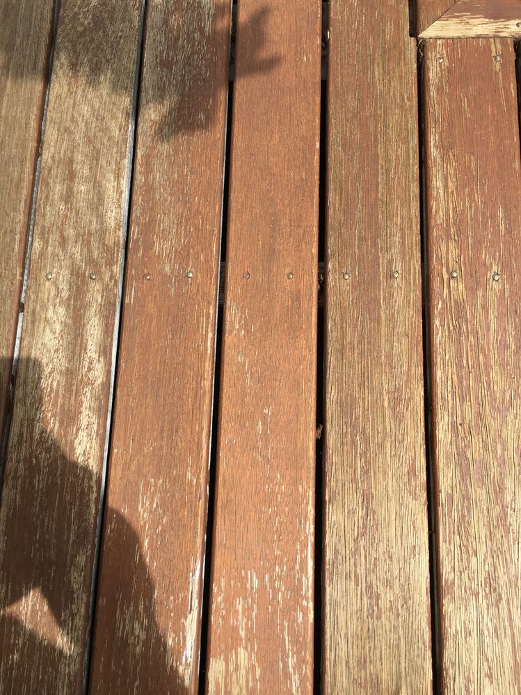

I shifted tactics to a paint stripper (Liquid 😎 which was a little more potent and got the result I needed. You can see how effective it was in the photo below.

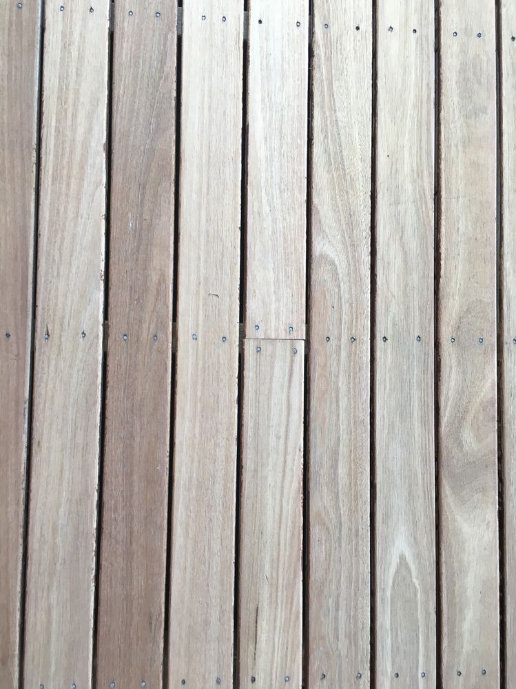

After going over the entire deck with Liquid 8 and the pressure sprayer, I decided to sand the entire surface. I wanted a really high quality result when oiling, and so took the time not only to sand, but to sand over the decking twice.
Below is a photo after a coarse sanding (P40 sandpaper) and then a fine sanding (P280 sandpaper). Smooth as a baby's bottom now!

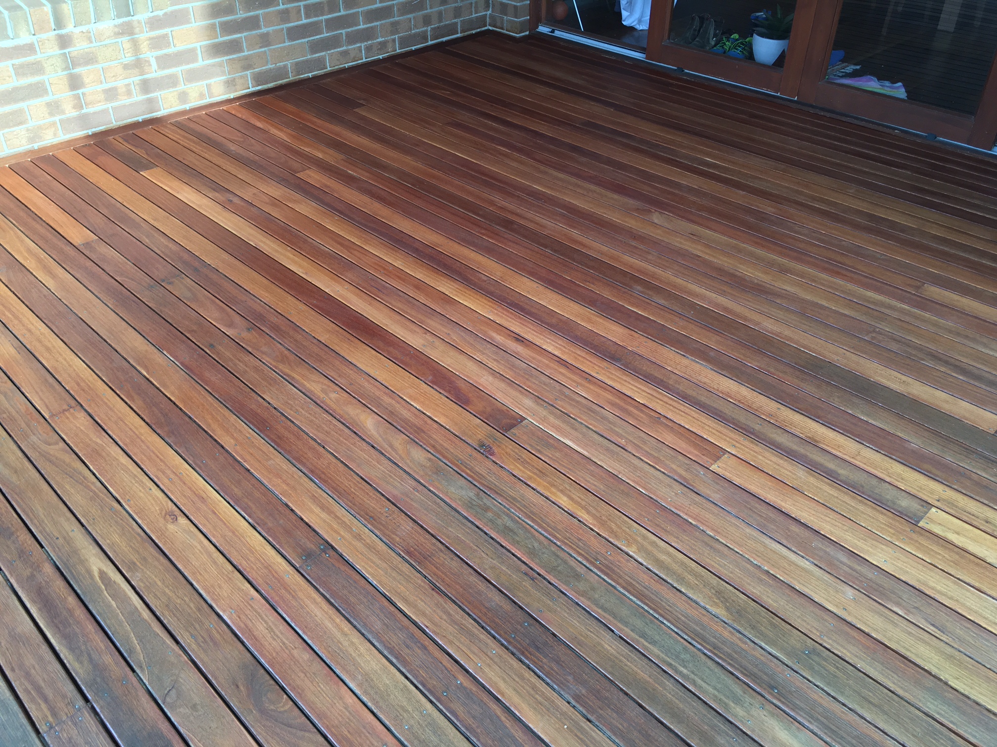

Here is the deck after the first coat of Intergrain Nature's Timber Oil:

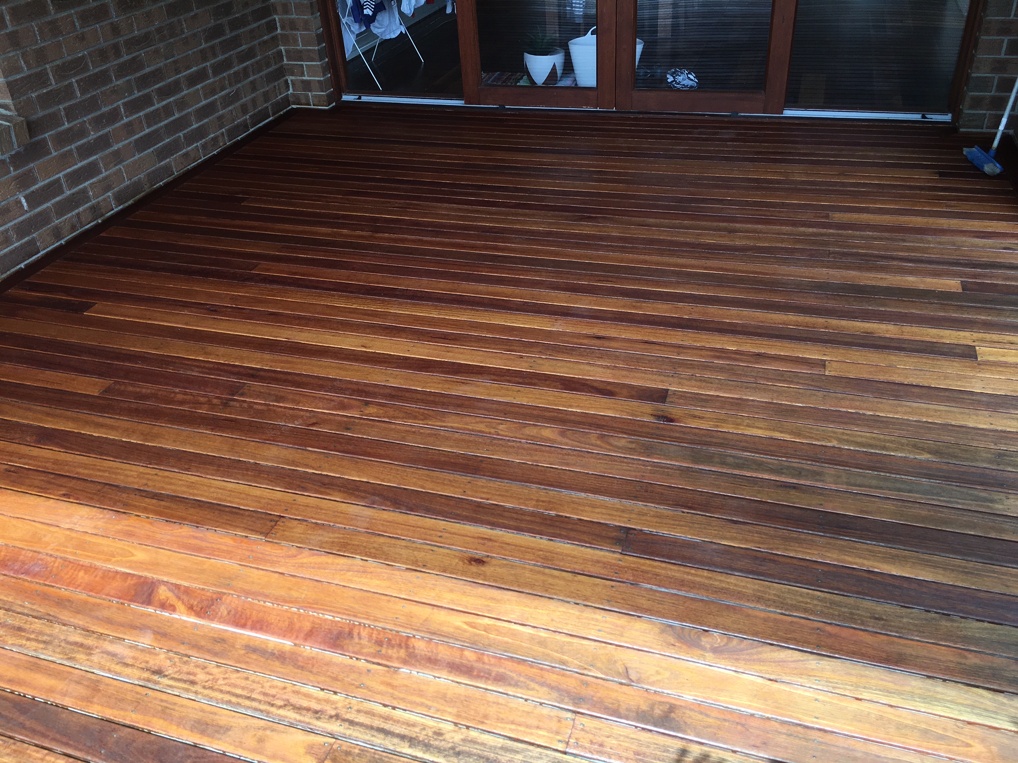

And after the second coat:
Now the deck is made from River Reds hardwood, which has almost as many colours as Spotted Gum, but it is primarily pinkish with the odd bit of almost pure white. The whiter boards have taken on quite an orange tint, which isn't overly pleasing, but I think next year when it's due for another oil, I'll whack a Jarrah tinted Nature's Timber Oil over the top and darken it up a bit.
