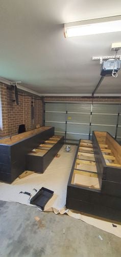

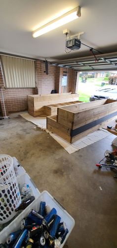

 I pre built all the pieces in my garage added supports for the seat base and the base of the planter areas and then painted all the pieces.

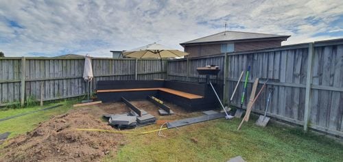

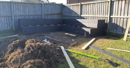

 And then took it all out the yard to piece it all together.

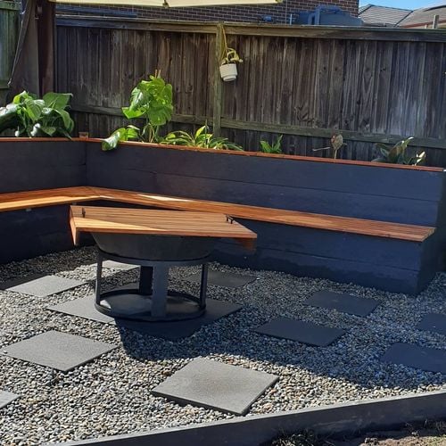

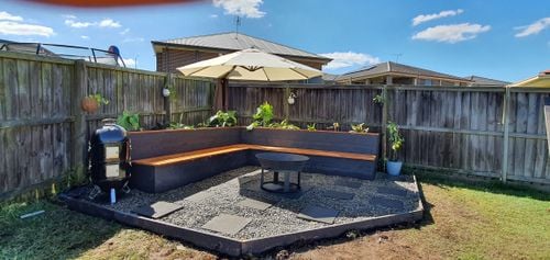

After that it was just a matter of creating a boundary to contain the pebbles and put pavers and a firepit in.
I built the lid for the firepit so that we can use the area for entertaining year round as it doubles as a small table.
The area has already had a good workout as we had our wedding reception in the backyard and it was where everyone wanted to be.
