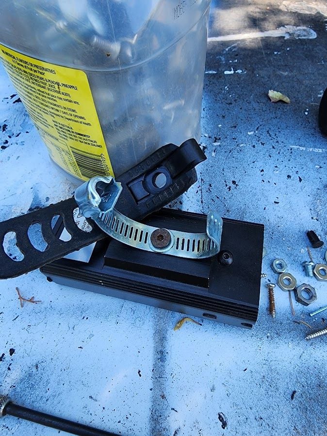

I bought a cheap bicycle light for my cheap bicycle.
It's basically held on by a rubber band method.
No matter which rung you stretched it to - it wobbled when riding.
Before I could find a solution it was stolen. Easy to steal.
So I bought another one.

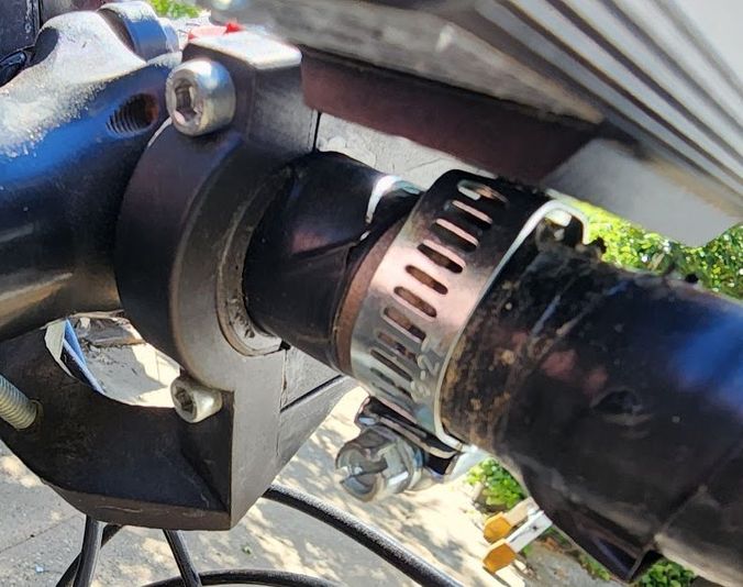

Today I tried an adjustable pipe bracket.
Aesthetically it is not very pretty.
But rock solid when riding and theft will now require a slotted screwdriver or 8mm socket.

I'm sorry to hear your bike light was stolen. The threaded clamp should make it harder for the light to be simply taken off. As you mentioned they'll need a screwdriver to remove it.
