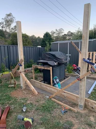

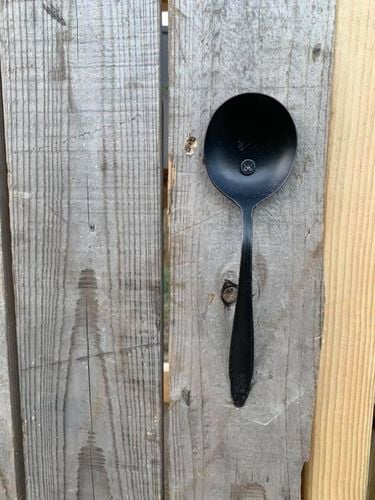

originally started this outdoor area to enjoy Easter with the family at my place. It suddenly became a space where we would honour and cherish my mums memories. I made use of free pallet wood for all exterior panelling, pinched a few spoons from her kitchen for handles and got creative. This is my first project, so I’m a newbie when it comes to building anything! EABDF4C5-2131-41C7-A4C1-EBFBD095EA0D.jpeg

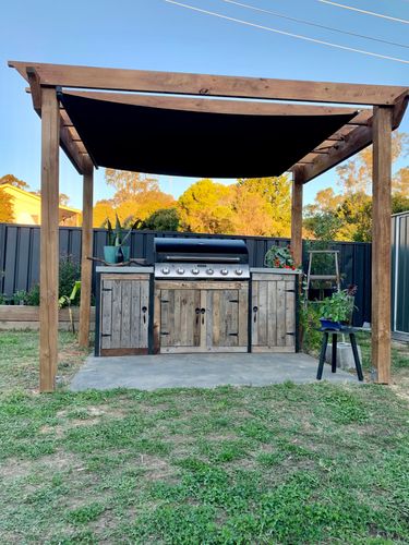

I had an existing concrete slab so I built a pergola with these dimensions. Post stirrups were cemented in place and I created the pergola with sawn treated pine 100x100, sleepers and treated pine timber. All profiles I cut with circular saw and jigsaw and sanded to round off profiles.
 Finished pergola.

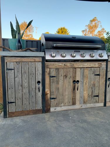

I measured the existing frame and constructed a new frame with small counter tops. I lined with cement sheeting and made cement counter tops (reinforced).
I attached a retractable outdoor blind for some sun blockout. The corners of the BBQ area I added some thin wood off cuts (2mm). Sprayed black and attached to break up all the pallet wood.
Please consult with your local council regarding pergola construction and height etc. as different rules apply. The Mumme Reno bar was a life saver to dismantle the pallets. It was money well spent for me.
