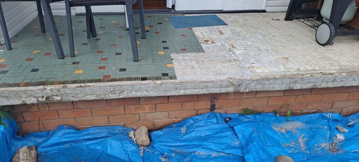

I'm preparing to DIY a small, low deck to extend an existing concrete patio at my house. I would like to use composite decking, and I would like to remove the existing patio tiles (already underway), and extend the composite decking boards over the existing concrete once the tiles are removed.

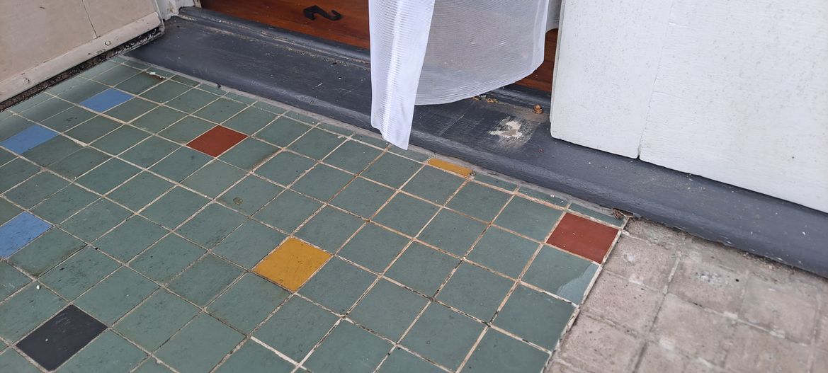

Where the patio joins the house door, there is 30mm vertical clearance from the cement patio slab to the top of the door lintel (see photo). I understand the top of the decking needs to be lower than this to prevent water draining into the house. Most composite decking I can find seems to be about 25mm thick boards, which means I haven't got much extra vertical 'wiggle room' on the cement patio.

Unfortunately, no composite decking producer would offer any kind of warranty or recommendations for installing decking directly to concrete as it creates an environment where mould and rot will take hold and cause premature failure of the decking.
Regardless of your efforts to increase drainage, there is not enough space here for composite decking to be a viable option. Unfortunately, 5mm is not enough clearance.
The only way I can see where composite decking will become a viable option is to remove the concrete patio, so you have enough room to install a timber frame.
