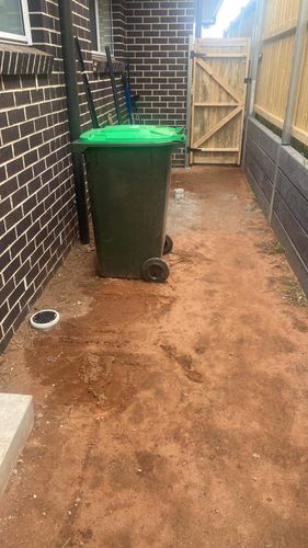

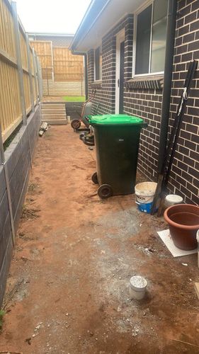

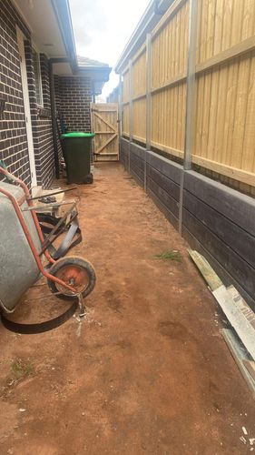

Hi, Im planning on laying pebbles all through the side of my house. Just wanting to get some idea how drainage would work? Eg. do i need to make sure my drain height is flush with base level soil and pebbles on top? I have some pvc sticking up the ground at the moment

How level is that soil in your yard? I noticed the steps in the first photo and the bottom step looks shorter then the others, is the earth higher there? Or is it just perspective? Which way does the water tend to pool now when it rains? and does it drain away in any direction?
If the yard needs to be leveled you could use the soil and raise it up to level with that stormwater drain grate. Or cut the pipe down a little and have it level with the top of your pebbles. I am not keen on covering the drain with pebbles (Think I misunderstood that part :smile: )
Are you putting down a weed mat of some kind? Are you thinking of having pavers down the pathway as well?

thanks for the very insightful questions. The steps are all the same height. The photo is just very deceiving.
the current ground level is almost level, the pipes need cutting down. I will need to slope so that water will run to the drains.
The only reason im hesitant to flush the top of drain to the pebbles is that the water would need to raise upto the level of the pebbles for it to get to the drain and drain away. Its probably not that big of a problem but it just means water will sit and pool until it dries bcos it cant drain anywhere.
let me know your thoughts.

Mmmm you could put in a short french drain and connect that to your stormwater pipe below the surface?
I put a french style drain in with pavers on top. For yours you could cover with gravel and then put pebbles on top and connect to that stormwater pipe.
This is my project but only the last two steps are to show how you could connect the drain to the stormwater pipe so no puddles are formed
Fixing water ingress issues in garage
If you did the french drain with gravel on top it would solve your concern about needing to change the height of the pipe.

It's great that you've received excellent ideas from @Dave-1. Just to add to the suggestions made, I recommend drawing your plan on paper first so that you'll know where the French drain will empty out. This will also tell you how long the drain coil has to be.
Please note that if you plan on linking the French drain to your existing storm drain, I suggest engaging the services of a registered plumber.
