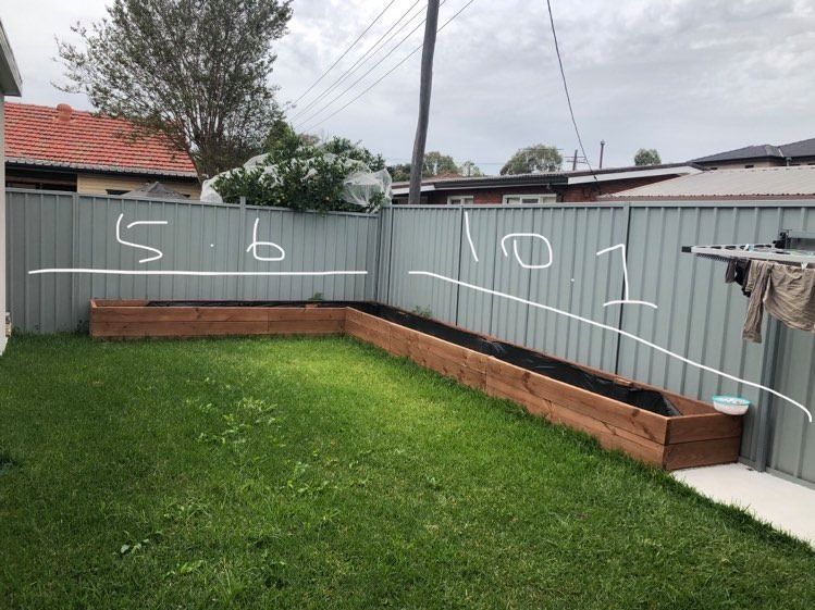

I was thinking of installing batons along the top edge of the colorbond fence and another horizontal baton just above the planters (ref image below). 2m high fence, but will have to cut to approximately 1.6m above the planters.
With reference to your image above, do I have to nail in every bamboo? Or would it be every 5 or 10 bamboo?

I don't feel it is necessary to screw through every piece of bamboo. The image was just for illustration purposes. I'd suggest fixing at the corners and then an additional fixing in the middle at the top and bottom. Six fixings should be adequate to hold the panels in position.
