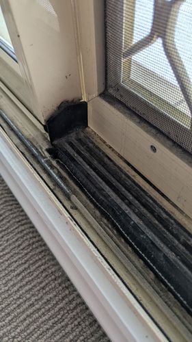

Hi I need to remove this from our balcony door to access the door. How can I remove this black piece?

This piece appears to be press-fit, meaning it is pushed into the hole and expands outwards.
You should be able to put a flathead screwdriver or flat implement behind this piece and gently lever it away from the frame.
There may be another press-fit piece on the other end of the window that would need to do the same to come out.
Give this a try and let me know how you go.
