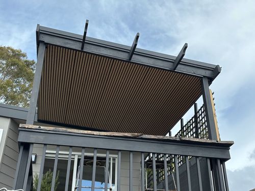

I have used these panels several times now both vertically and as a feature roof for an alfresco area. The problem with cutting what looks to be real Oak isn't. It's a vinyl wrap over MDF. So if you were to make cut-out style cuts, it will expose the MDF in the open cut face. I discovered this when I had to make cut outs to go around posts.

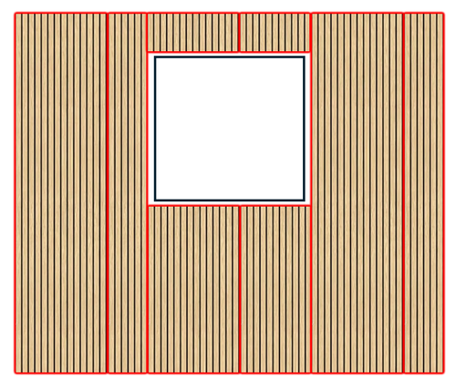

This is this it the layout and cut pattern I was referring to. This allows you to just cut there boards to length. You could use a fine toothed (one with min 40 teeth or more) circular saw blade. Mark out the cut line on the both sides and apply tape to the Oak side to help reduce breakout. Reduce the blade depth so the teeth are 5mm below the thickness of the blade. Make the cuts with the boards face down for a smoother cut.
