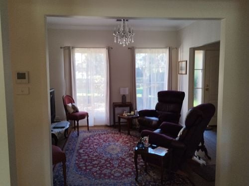

So we have two openings around a snug that we would like to put doors across.
The openings are 1980(w) x 2080(h) (pic attached).
There is no space for sliding doors that would disappear into a wall cavity, but we are happy to lose 1/3 of the horizontal space to a fixed panel (glass?) at one side. We do not want raised tracks across the floor of the openings.
Would barn doors suit this kind of opening, using a rail across the top? Thx

Barn doors could work for this kind of opening, but it depends on how much room you have on the right-hand side of the image. Since you're open to having a fixed panel on one side, you’d need enough space on the right to accommodate the barn door, which would cover about two-thirds of the opening’s width. Essentially, you’d want the remaining third (for the fixed panel) plus another third of the total width on the right side to allow the barn door to slide open without obstruction. If you have that space available, barn doors with a top rail could be a great option, and they would avoid the need for tracks across the floor.

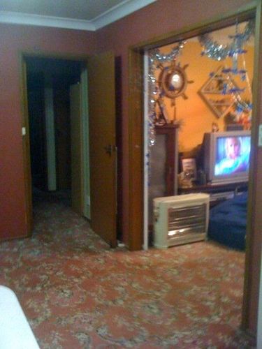

My old loungeroom had some frosted glass doors (timber Frame) They didnt have a runner on the floor tho had a short "guide" that stuck out maybe 1/5th per door (The door itself covered the strip)The rail was much like a shower rail on top with a cowl around the whole lot to mask the rail mechanisim. It was silent and glided smoothly.
This is the only photo I have of the door back then lol For someone who takes multitude of photos I still miss shots I should have taken.
You can see how close fitting the doors were, they kept the warmth in nicely and the sound was lowered dramatically.
I just went and had a look as to how I would replace those doors if I had wanted.
Cowdroy 915mm 60kg Centurion Sliding Door Track Set used on a standard door. No track onthe bottom bar the guide at one edge per door. Depending on the style of your doors you want, you could go for a covered door or a frosted window or even a chequred style. The width I would see what is a standerd size for the style of doors you want and then work out if when open you are happy with the spacing.
Having a look at the standard widths, you may need to order a slightly larger door as you want a little overlap of the door to the wall when closed totally.
