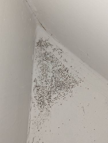

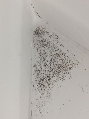

I've attached a photo of a strange pattern in the corner of the ceiling of our upstairs bedroom. I have no idea what it is. It is above the stairway and in a difficult area to access closely. Initially I thought it might be mould but I don't think it is... It is quite hard and has a 'stuck on' feeling.

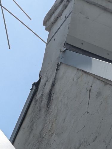

I've looked on the outside and it corresponds to where our chimney exits (not used as a real fireplace anymore, has a gas fireplace there now). There is similar black discolouration there as well.

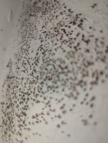

Some further pictures attached.
We have been in the house for a year and we do not think the pattern is spreading or getting worse... We have just been ignoring it but would like to try and fix it up before considering renting the house!
The other thing I was thinking was possibly some sort of old insect eggs?

From your first two images, I would say that it is definitely mould that has likely formed due to the flashing on the outside of the wall, allowing moisture into it. However, from the most recent images, the dark areas do seem raised, which is not something I've encountered before. Can you remove them by scraping them?
They almost look like small pebble aggregates in the wall. I'd try scraping them to see if they are easily removed. If you can remove them or scrape them off, I'd apply a primer and then repaint the area. Also, I recommend having a flashing expert take a look at the outside of the wall, as the flashing does look like it would allow water in during driving rain.
