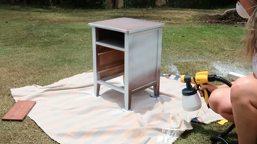

It was my birthday recently and my kids gave me an electric paint sprayer, the Wagner W200, purchased from Bunnings. I have never used one before, I normally use a paint brush and I enjoy that, but I thought if I start to flip my little makeovers it may look more professional if I use a paint sprayer. I decided to try it out on a little bedside table that was being given away on the side of the road and then sell it on the Facebook Marketplace. I was really pleased with the result although there were a few things I learned. I actually watered the paint down more than it recommended and applied more coats, I adjusted the nozzle so that the spray was finer and didn't come out as thick and realized it would be advisable to paint in a protected area as the wind outside created a problem at times with overspray and particles falling on the wet paint.
I was surprised how fast I was able to paint my project compared to using a paint brush as well as the smooth professional quality of the painted finish. I have added some photos of the unboxing and the table upcycle and also a video on my project. I'm pleased to say I was able to flip the piece and after advertising it I sold it the next day!

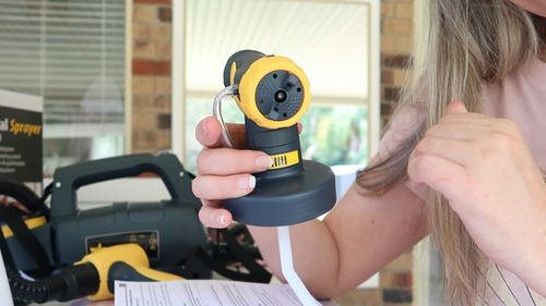

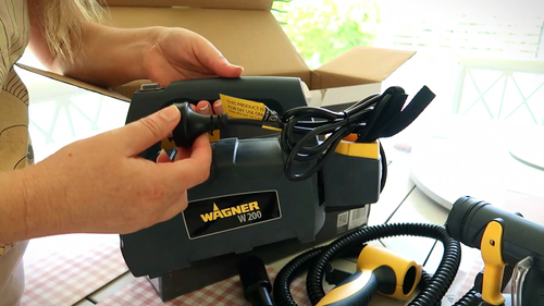

This model is electric and needs to be plugged into a power source.
This adjusts the paint flow.

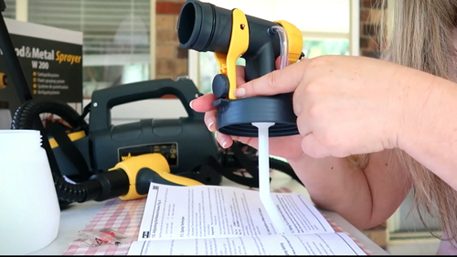

The nozzle can be adjusted to paint horizontally, vertically or reach corners.

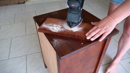

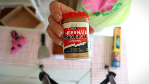

My trusty wood filler to fill in the old drawer handle holes.
I sanded the filler and also the cabinet.
Time to paint!

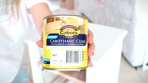

A coat of clear matte varnish should hopefully protect the top from wear and tear.

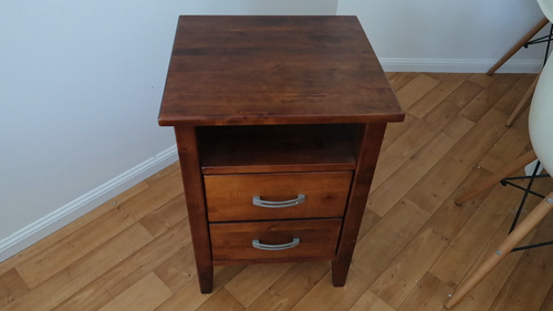

The little 'before' table I picked up off the side of the road was in not too bad condition.

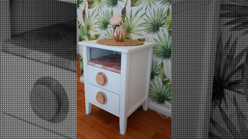

The little bedside table after a spray paint and decorative touches.

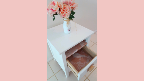

The lined drawers were an added touch.
