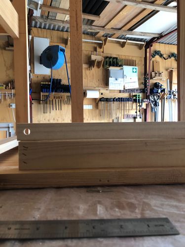

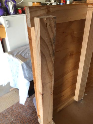

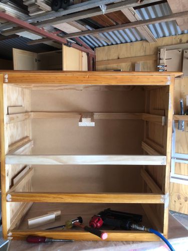

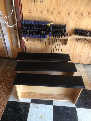

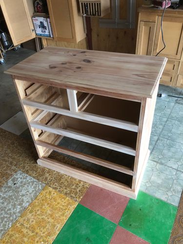

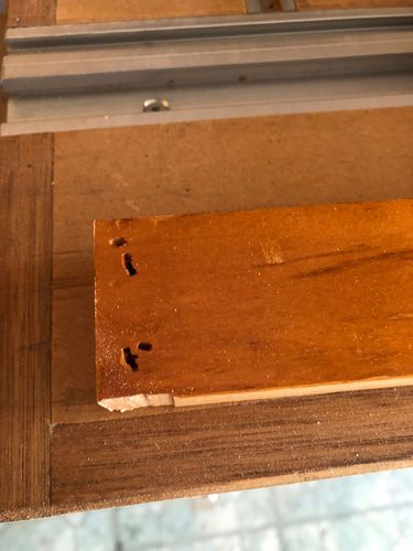

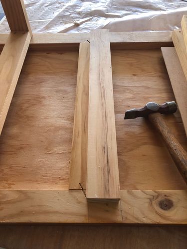

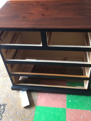

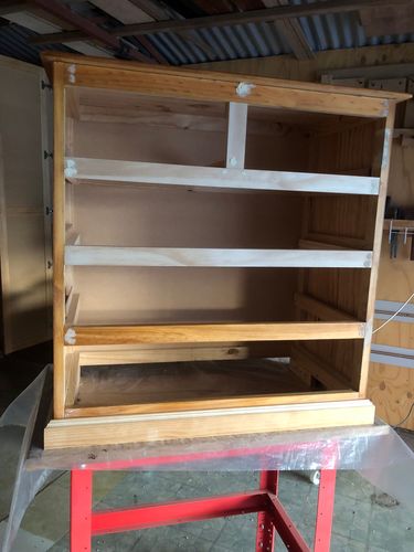

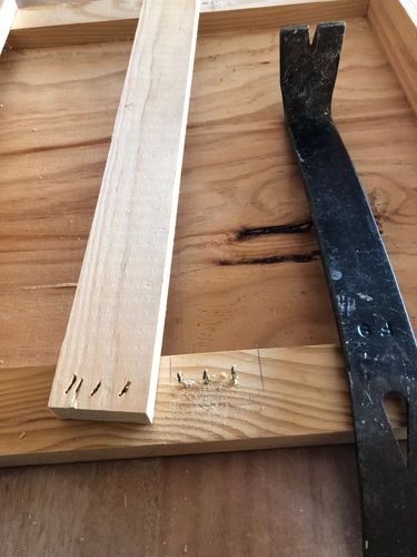

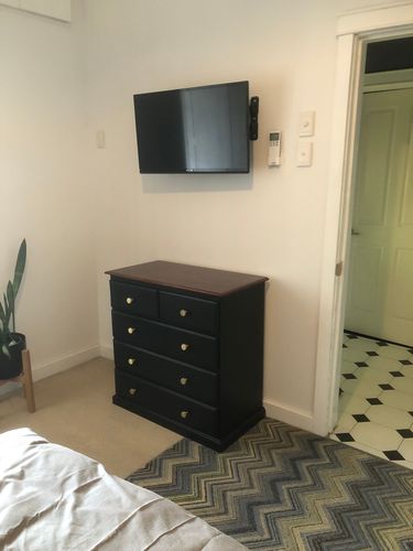

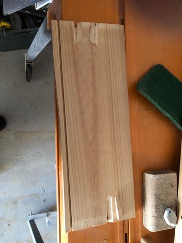

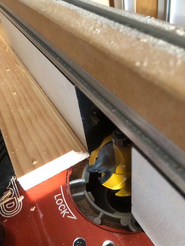

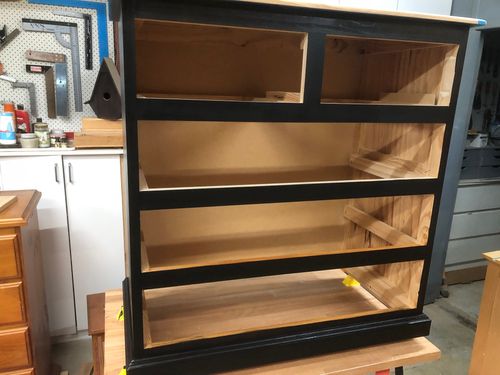

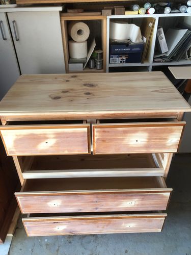

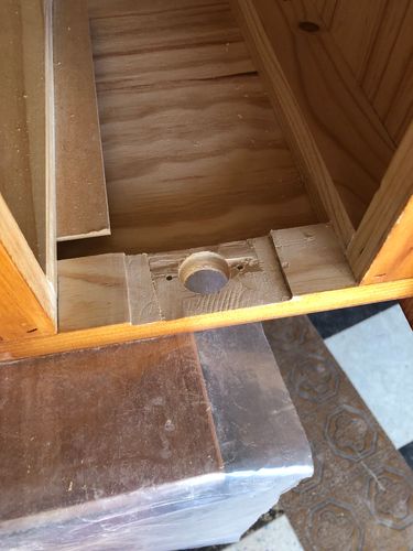

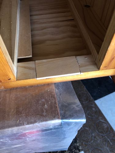

I had this old chest of drawers that needed repair, the timber drawer rails were worn out and it was difficult to pull out the drawers, they were always getting jammed. upon further investigation, I found that the drawer rails were worn out, so I decided to replace and /or invert the worn rails.

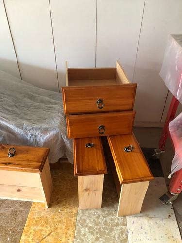

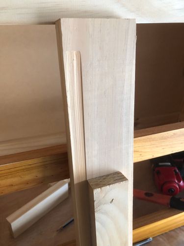

The drawers were also worn out, instead of adding timber to replace the worn out section of the drawers, I had some old salvaged pine drawers that I used to replace the worn out drawers. I am very happy with the results, I now learnt that you need to lubricate the timber rails to prevent the rails wearing out, I used wax paste.

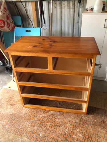

Before photos:

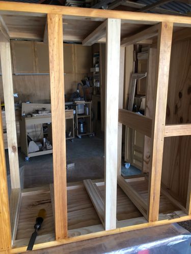

Remove old drawer fittings.

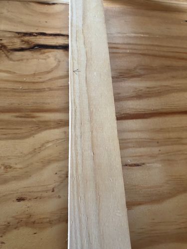

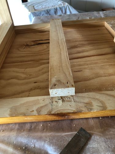

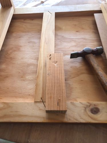

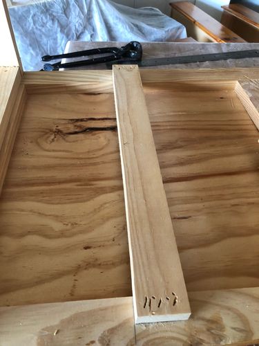

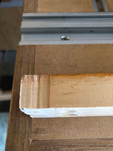

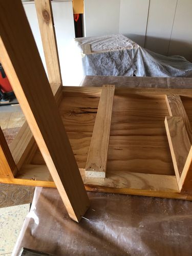

Replace all worn out drawer rails

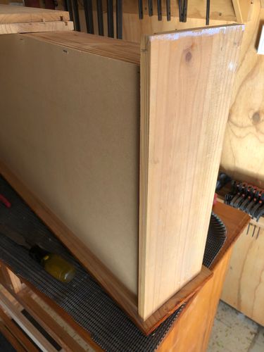

Replace worn out drawer sides

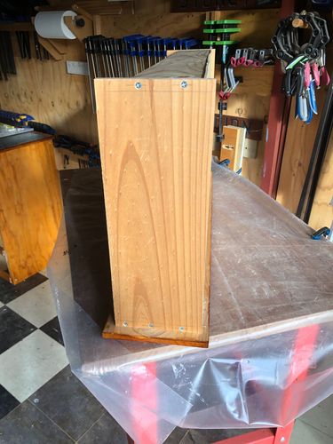

Remove and refit backing board.

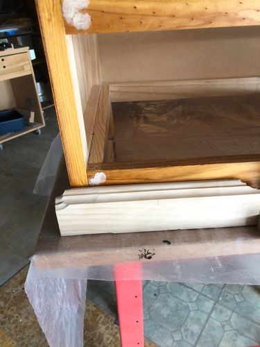

Make up and install a new kick rail.

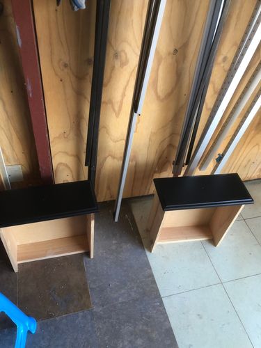

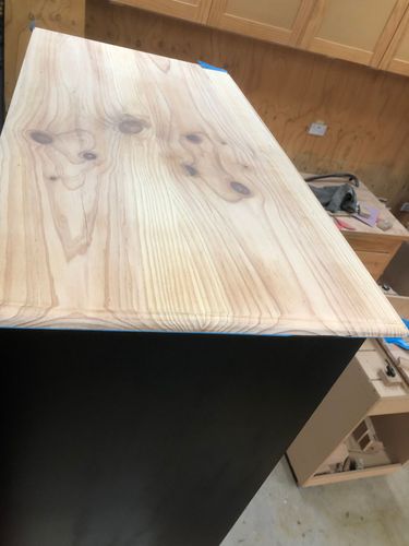

Sand top of chest of drawers until back to bare wood to prepare for staining.

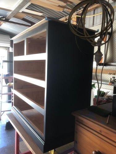

Sand and patch the rest of the unit to prepare for painting.

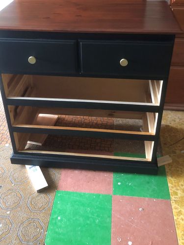

Mask and paint satin black - 3 coats using brush and 4mm nap roller.
Stain top of unit - 4 coats to obtain the colour I wanted.
2 coats of clear coat varnish, water based.
Install new knobs.
