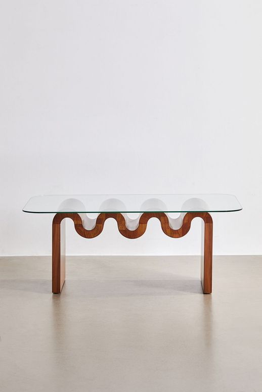

Hi! I'm looking for suggestions on how I can build this coffee table. It looks like there are 9 individual parts to it (2 legs, 7 curves).
Do you have any suggestions on where I can get the pieces cut and shaped?

By my count there are 17 pieces to make that.
Not sure of the width but it looks like you could use a forstner bit to make the inside curves or a large bandsaw for everything, then lots of sanding.
Another way is to glue up segmented cilinders that would be turned into the shape then cut in half, given the grain pattern it looks like they didn't do it this way. Given the tools I have and what is coming it is how I would do it, I would have to use the clubs bobin sander though.
A bobin sander may be the best choice. to neaten it up.
Looks like the design could be adapted to make a wine rack, one of those jobs where price is no object.

This unite has a number of laminated components to get the perfect shape more than likely it has been steamed and pressed into shape. I would like to see a side view to see if it has any other laminations

Constructing a table like this would be considered a relatively advanced woodworking project. If you were looking to have someone cut and shape the pieces for you, you could try a Men's Shed as the gentlemen there will sometimes take on private jobs. As @Brad has mentioned, you'll likely find a Men's Shed the best place to start as few people would have the equipment needed to create those curves at home.
