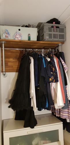

A quick weekend project, replacing an ugly white melamine builder shelf in my daughter bedroom

started by ripping out the existing melamine white shelf and the supporting packer underneath.
Then, go to bunnings (hahhaa. My fave shop)

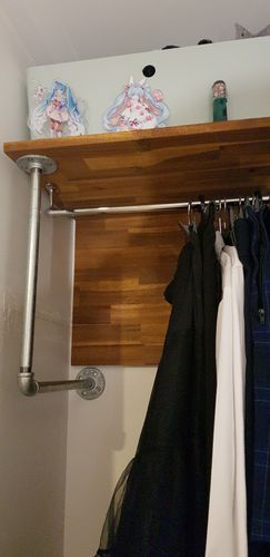

I use interbuild project panel and cut to desired length, 450 wide is enough for shelf (hanger should be 350 from wall)
I use the galv pipe for support (can be spray painted if you don't like it raw)
Fix the angle panel to the wall for positioning (1 screw is enough) then fix the metal pipe to the wall and under the panel for support.
