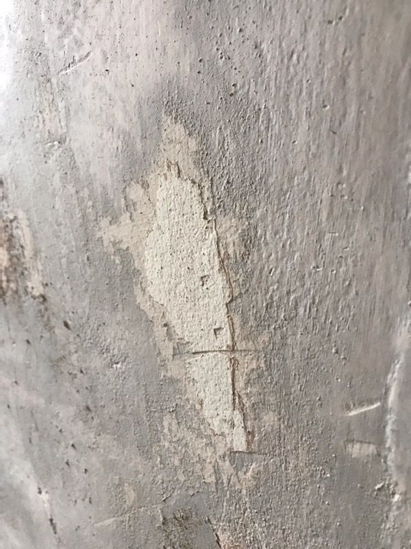

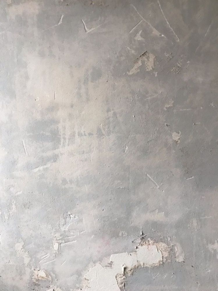

We recently used Peel Away to remove layers of  paint from our circa 1940 home in the Blue Mountains, and have been left with small dents/scrapes in the wall. There also seems to be a sticky (solid) substance left on the wall, even after scrubbing down with water/cleaning agent.
Two questions...
Does anyone know what the substance on the wall could be? Render perhaps?
Does anyone know what we need to do to get this wall smooth and ready for painting?
I though we might need to sand the wall then re-apply limestone render, yet my husband and I are novices and rendering might be out of our league.

I suspect that the Peel Away may have leeched into your concrete wall and that's why no amount of cleaning is working, and you are left with that sticky residue. I suggest speaking to the supplier of the chemical and finding out if it has a neutralizer or a prescribed way to wash it off.
Some parts of your wall are severely damaged others are still in good condition. But in order to get a good flat finish, I propose rendering the surface again, in this manner the wall will be totally flat. The choice is up to you if wish to attempt to render this yourself or hire a trades person to do the job.

The wall looks like its concrete? The sticky residue looks like it may need some more elbow grease to remove.
What type of surface do you want to end up with? Something smooth say like an interior wall? or an exterior renderd wall?
Any chance of a further back away shot of the entire wall so we can get some perspective of the area?
Just had a look and there is an external putty you can use for the gouges Selleys Gap Filler 435g Spakfilla Heavy Duty Interior And Exterior You can sand it and paint it as well.
When I have removed wallpaper and gouged the wall (the wall was plaster) It took some effort in removing the old glue from areas. Was worth it in the end but I was cursing the original people several times.... Id give it another one or two goes to remove that sticky surface. Walk past, give it a go, come back later is another way I have tackled a pain in the neck part of a reno.

Hi @selvins , I tend to agree with @EricL that what you are feeling is residue of the Peel Away itself. The product Factsheet suggests that another layer could be required in some cases. If you have some left over, you could try doing a test patch to see if that softens and removes the residue. Unfortunately requires another 72 hour wait, but could you save you time and effort in the long run if it turns out to be the answer.

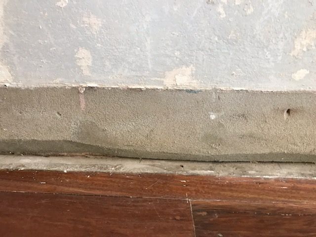

The walls are double brick and rendered. The sticky substance is now hard, and just forms hard clumps as can be seen in the pics. My concern was that I didn't know what the substance was, and didn't want to dig any further, and do more damage in case it was the render.
I've also sent another pic as requested, and included one showing the difference  between where the skirting boards were taken off and the painted wall. I think as you said it still might be old residue left over...
I think after reading these posts we might repaint with the Peel Away again. Not looking forward to that as it was beyond difficult the first time, and unbelievably messy! We'll also use the gap filler that you suggested and sand after.
