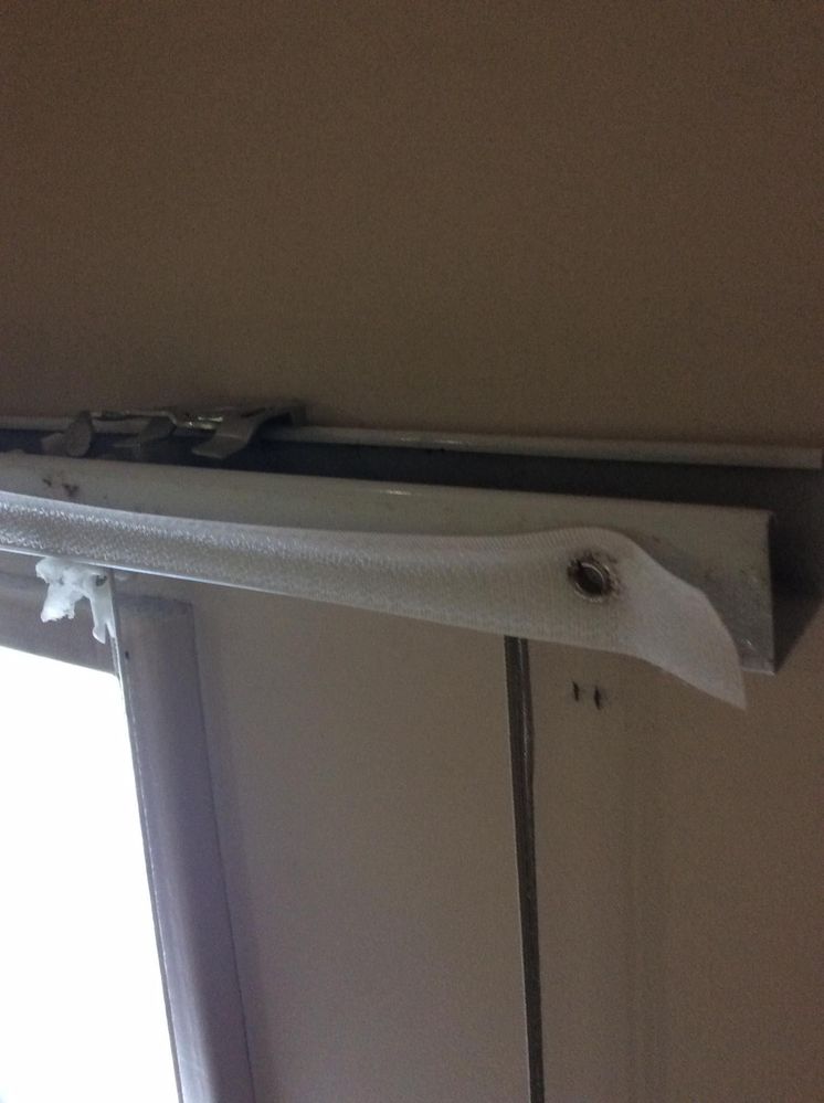

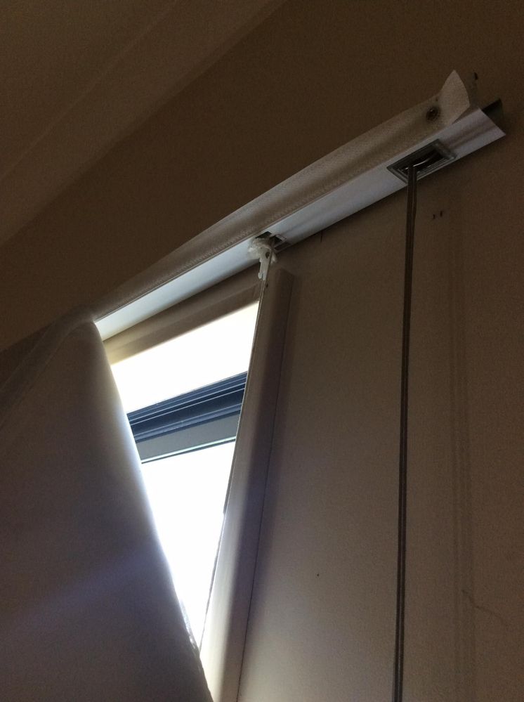

I stay in a rental home and we currently have a set of blinds installed which broke a few days after moving in. The blinds can no longer roll up. We want to remove them and install curtains (the cheapest and easiest way possible) before our newborn arrives in a week's time. Would you have any tips on how to remove this, please?

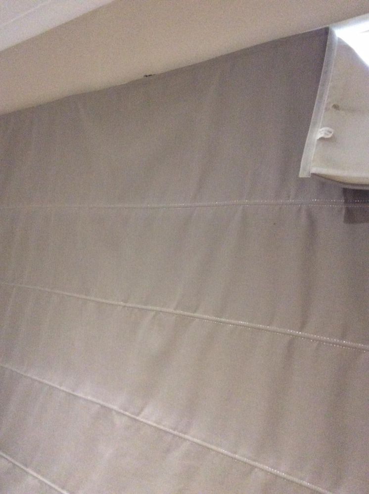

Just to clarify, is that a curtain that is attached to the blind front with velcro, and does it not provide the window covering you are looking for?

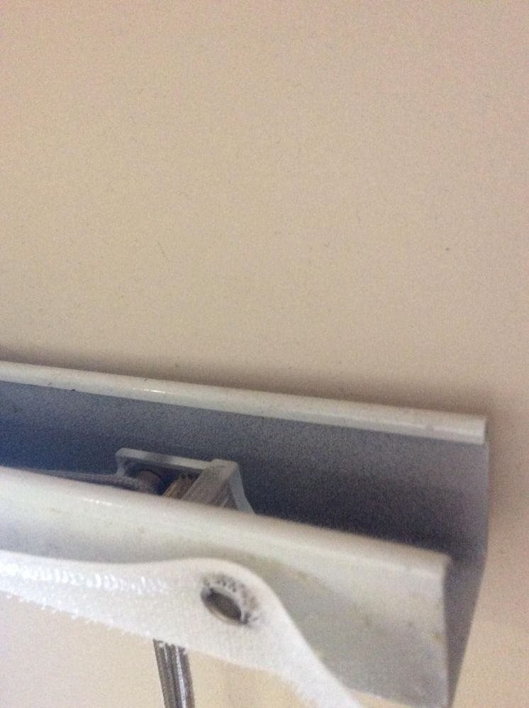

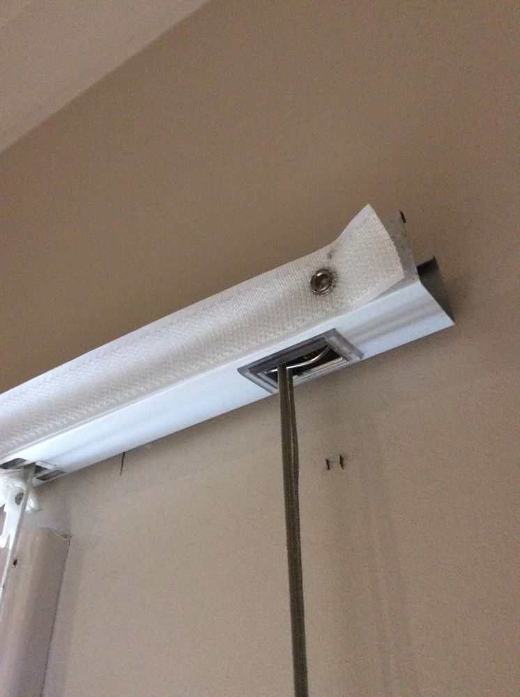

There appears to be some type of bracket, with potentially a locking arm in the image below. I'd suggest that's how the blind is retained on the wall. Try moving the arm to see if it releases the blind from the bracket. I have similar blinds and brackets, but mine just pull out of the bracket when tilted downwards.

Thank you so much for this. I have just tried it and can see that it is easy to remove. Any chance we could just get a replacement curtain/blinds for it there at bunnings?

In order to get a compatible blind, I suggest bringing the old one to the store so that you can compare it with the new ones to make sure that they are the same size and that they will fit in the old brackets. The other option of course is to remove the old brackets and install the new ones that come with the new set.
However, if you prefer curtains, I suggest getting a full kit that comes with brackets. This will make it easier to put together. Please remember to measure the position of the old blind clips as these will be your mounting points for the new curtain rail. It's important to get a set that is not shorter than the space between these old clips.
