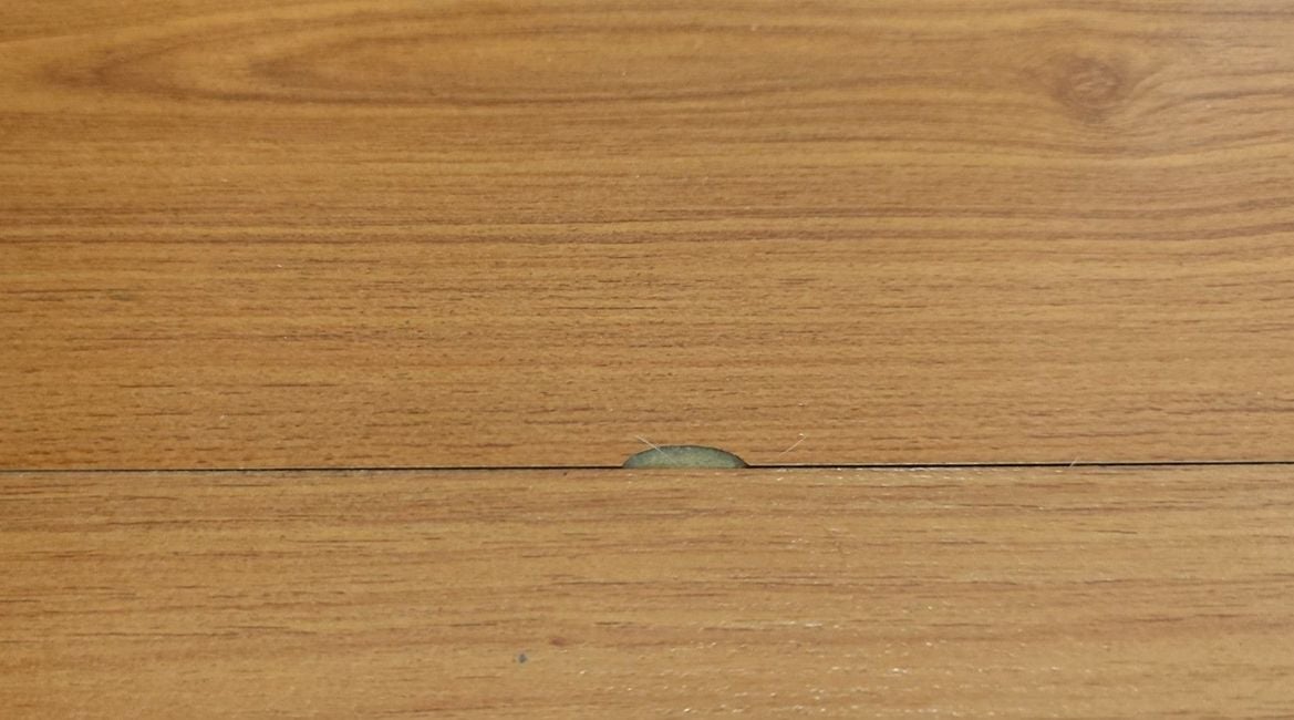

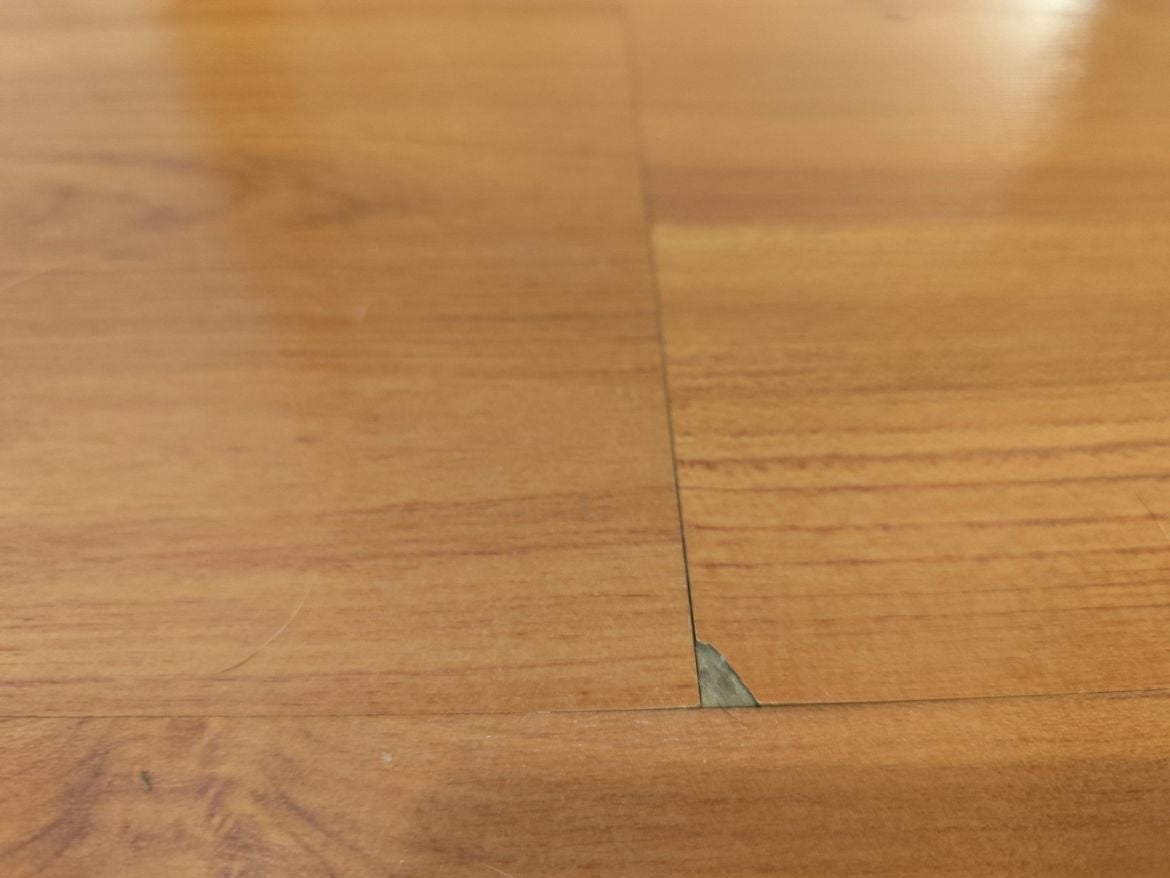

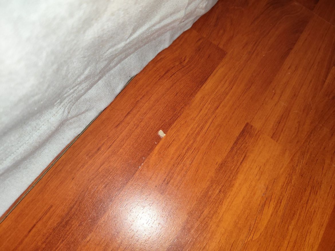

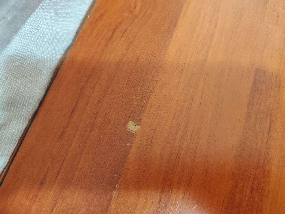

Hi All,
When my partner and I bought our first home some months ago, we have realized some of the flooring in parts of the place is lifting up in some areas.
Apart from that, we also found some chipped marks in the kitchen and bedroom and would like some guidance on how to fix it and if it's worth repairing in terms of costs. (Trying to keep to a good low budget).
Any suggestions, help with how to go about this and products used from Bunnings to achieve the desired result would be much appreciated.

Hi @Jay_11,
Looks like you have at least a couple of different types of flooring.
You might like to try Waxstix Timbermate Touch Up Crayons, which you rub or melt into the scratches and chips. There are plenty of colours to choose from, so you should be able to get a close match for each board. When there is some lighter and darker variations to the timber, you can mix two colours together as per the video below.
Hope this helps.

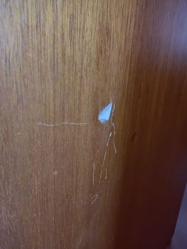

I forgot to post earlier that one of the bedroom doors had a dent in it prior to moving in and it looks like someone tried to fix it with possibly putty but it's not flattened and still dented.
Would you have any advice on a quick way to fix this some Bunnings products and match the wood colour of the door?

Hello @Jay_11
I suggest sanding the surface lightly trying to remove the white filler that was placed there. Once you've removed as much filler as you can I suggest using Timbermate Wood Filler. I propose visiting the store and looking at the colours available. Once you find the colour that is close to your door colour that is the filler to use. Your objective is to fill the damage with just enough filler so that it is level with surface of the door.

I bought the wax sticks from Bunnings today for the little chips on the floor but as for the door, when using the wood filler, does it need to be sanded down and painted? As the door isn't painted with any colour in particular, I am not sure how it would be painted

Hello @Jay_11
If the filler on the door is proud of the surface it can be sanded down. In regards to the paint, your door appears to be coated in a clear natural finish. I propose getting a Cabot's 250ml Natural Aquadeck Sample Pot to touch up the filled area. It does come in other stain colours so please look and choose carefully.

Hi Eric,
I might buy some sandpaper around 100-120 grit just in case it doesn't smooth out. Thanks for the advice and recommendations. I'll take a look at those sample pots and see what matches closely. Thanks again!
