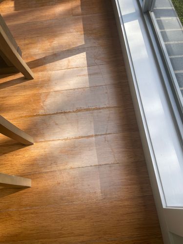

Hi @RohanGill,
It looks like the varnish on your flooring
Are you aware of what caused the stain?
It looks like there's a line on the right side of the stain that makes me suspect something has pooled there. Possibly water or a cleaning chemical of some sort.
The next question I have is are you aware of what type of flooring was used?
It looks like timber but there's a chance it is a timber-look flooring product like Laminate Flooring or Hybrid Flooring. Understanding what type of flooring you have will help guide our approach.
The first thing I'd suggest is to use a light abrasive pad like these Scotch-Brite Non-Scratch Scourer Pads to see if you can remove the stain with some light scrubbing. Pick a small test section, apply some water and lightly scrub the stain in a circular motion. If you have some success, you can then move on to a larger section.
I'm wary of offering further suggestions before I have more information, so once you've gotten back to us, I'd be happy to offer further assistance.
Let me know what you think.
