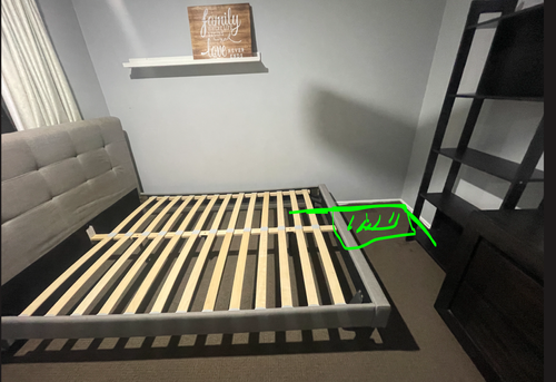

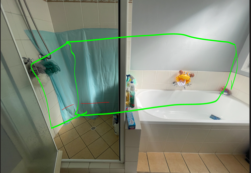

I just realised that I had forgotten to paste the picture of my bathroom and room where I think the damage is.
Red line, where I think the grout cracks were and where the leakage happened.
Green rectangle is where the wet carpet is. The moisture may or may not have reached along the wall.
