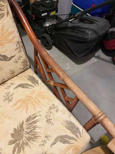

Hi @Jason
I have attached a couple of pics of the chair arms as they show the worst of the wear. Thanks for getting in touch! Again, any suggestions are more than welcome!

You have a few choices on how to proceed. It all depends on what you wish to do with these chairs. Do you wish to keep its character and not change anything about it, but keep it protected at the same time? Do you want it to give it a fresh new look? Do you want to colour it? I've written some options for you to consider.
- The first option is to leave the finish as is and give the cane furniture a thorough wash with sugar soap and re-varnish. This will keep the character of the chair with its faded parts but it will now have a new protective coating on it.
- The second option is to give it a detailed sanding. You will remove all the old varnish on it and reapply your choice of stain and varnish. I recommend using the Ozito 200W Detail Sander.
- The third option is to wash it again with sugar soap and apply Dulux 1L PRECISION Maximum Strength Adhesion Primer White. This will allow you to paint the chair any colour you like without having to sand the chair down.
Please look carefully at the chair and make sure that it is still structurally firm should you decide to sand it down. Cane chair bindings will sometimes become brittle as time moves on. It may be something to consider as it becomes another item that you may have to repair.
Here is a handy step-by-step guide: How to restore wooden furniture
Let me tag our experienced members @TedBear and @tom_builds for their recommendations.
We look forward to seeing your chairs restored and ready for use.

I paint a lot of old furniture and have dealt with cane furniture often. In your case, if it was mine, I would give it a light sand using 240 grit sandpaper. Personally I would do this by hand. You'll find the varnish, being so old, will be quite brittle, so should come away quite easily. If you intend re-varnishing, best to sand all the varnish off. It'll be tedious, but worth it in the end. If you'd rather paint it, then all you'll need to do with the sandpaper is get it to a smooth finish, and won't have to thoroughly remove it. Wipe it down afterwards with metho, which will remove any excess dust, dirt and grease. I generally just use a spray paint, such as Rustoleum Primer + Paint, which has very good adhesion. It comes in a wide range of colours, although classic white (in Rustoleum it's Blossom White) will team with any decor and fabric. Go for either a satin or full gloss finish so that keeping it clean will be easier.
I'd love to see what you do with the chairs. Good luck!

The suggestions of @EricL and @LizzieCro are great, and obviously give you a number of options. I'm a bit of a sucker for natural wood finishes so I like the idea of giving it a gentle sand back, possibly even a light stain to bring back some colour, and then a fresh coat varnish.
