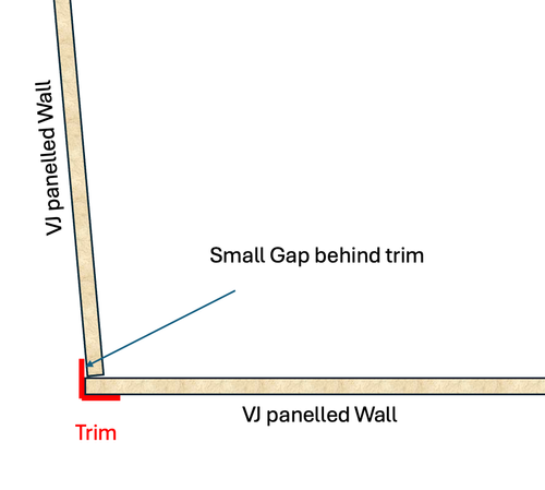

Re: How to finish single wall VJ paneling?
Sorry, does this make more sense @Francois ?
There would be a small gap behind the external trim but not seen
Nailbag
