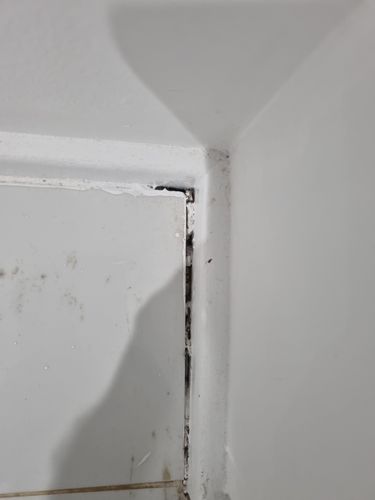

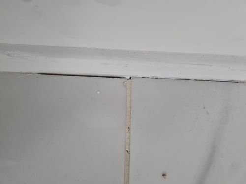

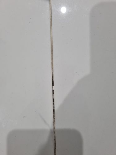

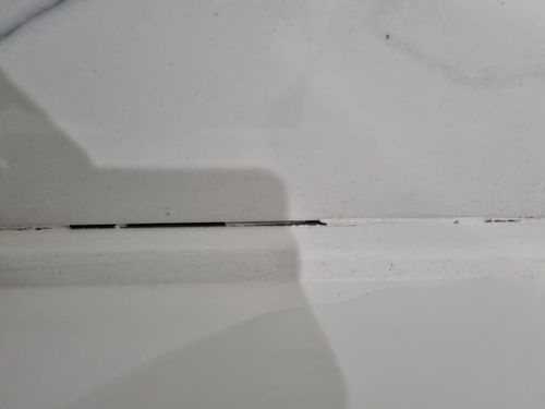

Hi guys,  I recently moved to a house where it has evident gaps between the tiles in the living room and gaps the corners between plaster wall and the tiles.
Can you please suggest a permanent way to fix the same.  Photos attached

For tile to wall filler applications, I suggest using Selleys 475g No More Gaps Interior Multipurpose Gap Filler. It is an easy-to-use gap filler ideal for filling gaps and cracks around skirting boards, cornices, and inside window & door frames.
For the tiles, I recommend using Dunlop 250g White Ready To Go Tile Adhesive And Grout. It's ready to use and comes in a compact bottle no mixing necessary. Please note that if the old grout is cracking and coming off, it must be removed before applying new grout.
Here are some handy step-by-step guides:
