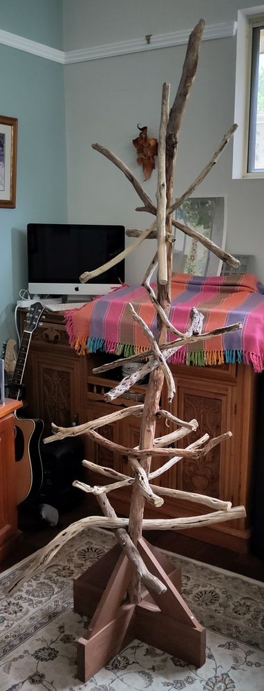

We obtained a custom made Xmas tree that uses various red gum branches. Each of these branches are attached via screws to each other and the main trunk. Whilst this worked for this year as its wood we don't expect the screws will hold up year after year. We're looking for advice on what type of bracket may be useful for this purpose? Our alternative is to consider square lashing and relive our time in Scouting.
Does anyone have any suggestions on what type of bracket/s we could use that don't involve repeatedly screwing into the wood?

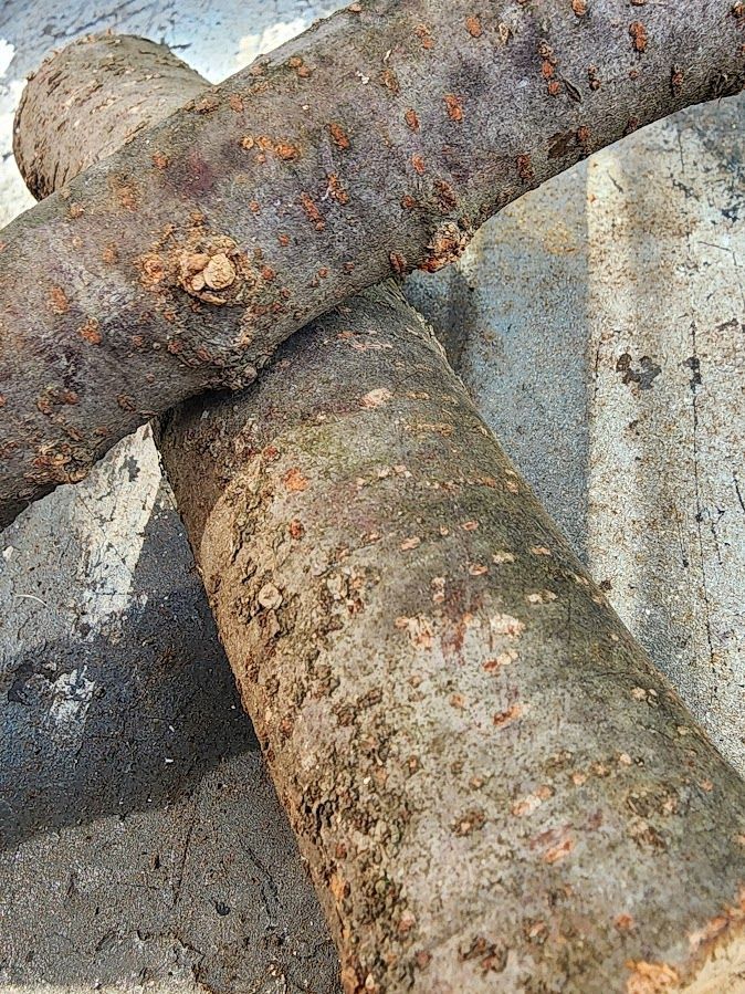

"relive our time in Scouting"
I call this the 'Daniel Boone Cabin Technique.'

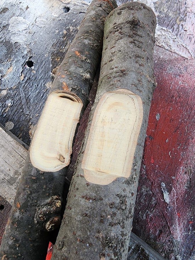

I propose sanding the rounds so that we have two flat surfaces. This will be trial and error for best fit. It's very hot outside so I didn't bother to be precise but you get what I mean...

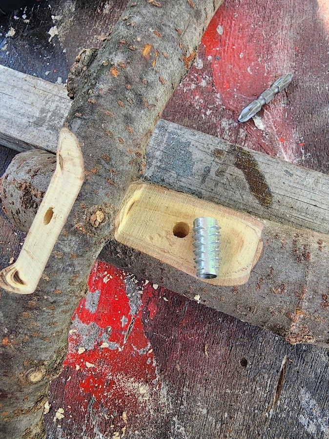

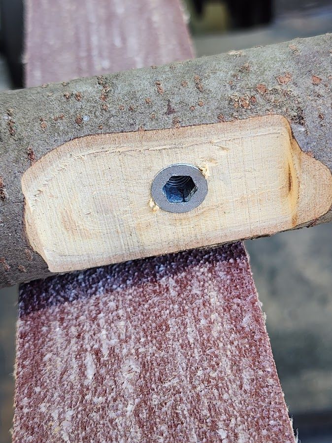

Drill through one side and not through the other...
Then drill out for the fastener.

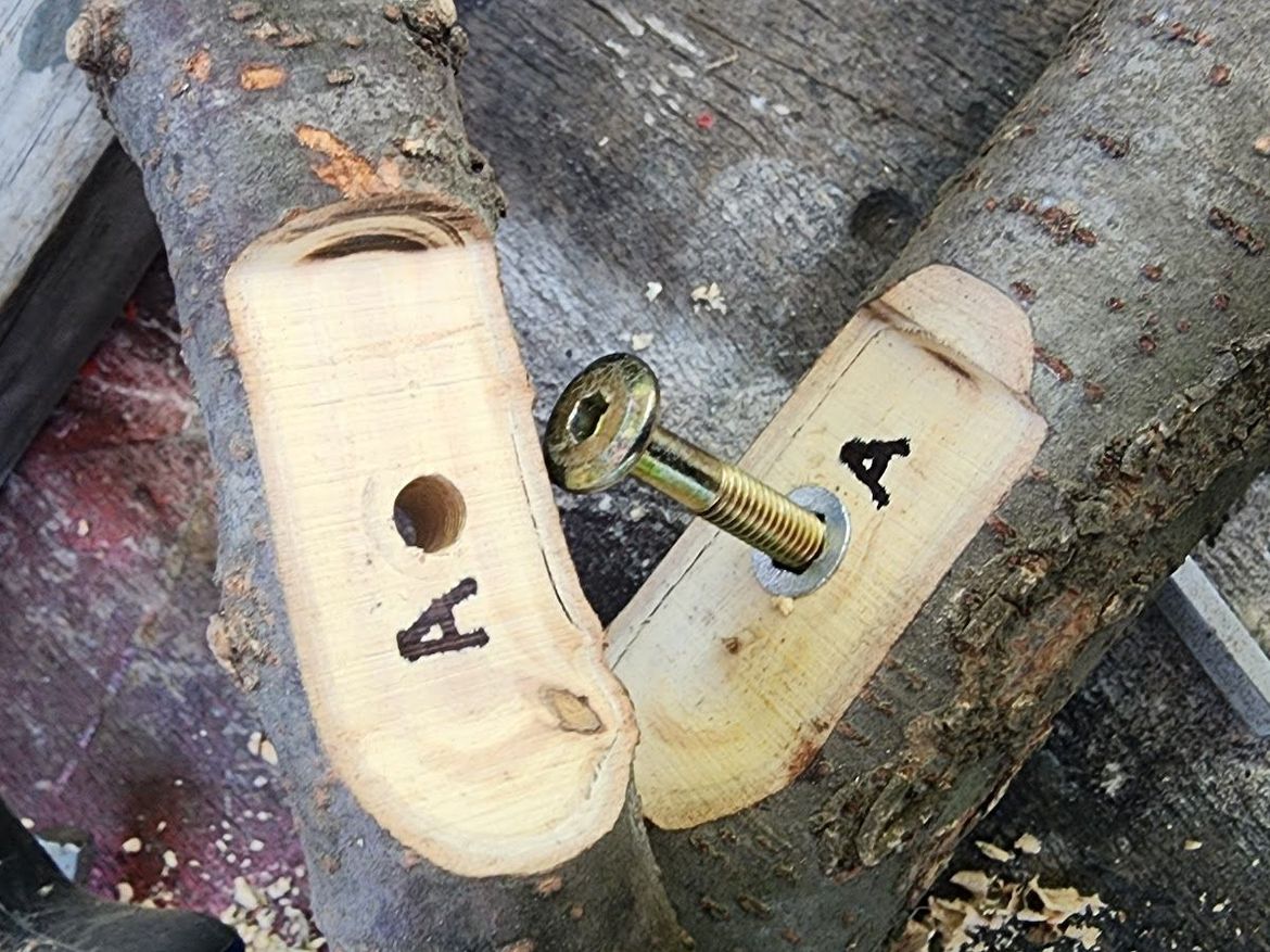

Number/letter each join.
Re: How to attach branches to Christmas tree?
Together at last.
Then deconstruct and pack away ready for Christmas. 😁
Laborious process, but worthwhile in the end.
I'll be immensely strong.
Hang anything on it.
And you can adjust the branch angles - slightly.
