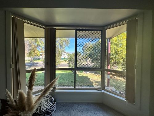

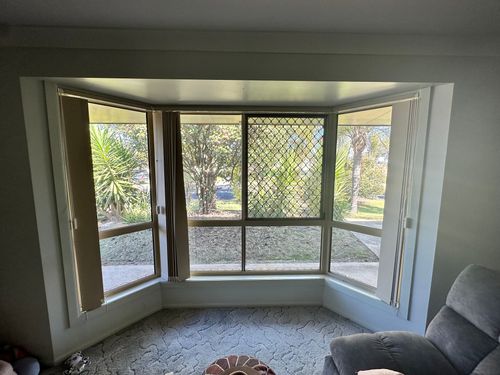

We have two bay windows in our home that currently have these horrid blinds. Wanting to install plantation shutters - is this possible and if so how do I achieve it? Thanks!

Hi @Liv95
are you building your own shutters or purchasing made to order, if made to order, you need to measure all the bay windows in segments, measure each window, length x width. Also check is each section is square. This is the problem I had, this is why I made my own solid panel shutters, I allowed clearances all over to compensate for the wind being out of square, then I just made filler timber pieces to all for the out of square.

Hi @Liv95
It's great that you've received excellent advice from @JoeAzza. His recommendations are spot on. Just to add to the suggestions made, I propose thinking about the number of plantation shutters that are going in each bay and where they'll be mounted on.
Looking at the picture you posted, it seems like you have aluminium framed windows. You'll therefore need a timber post on the angle where the windows meet. The posts will serve as mounting points for the shutters.
To give you a better idea of what I mean, I've posted a sample sketch below to show you where the timber posts would be installed. The Plantation Shutters can be ordered in custom size so please make sure to double check your measurements before ordering them at the special orders desk.
