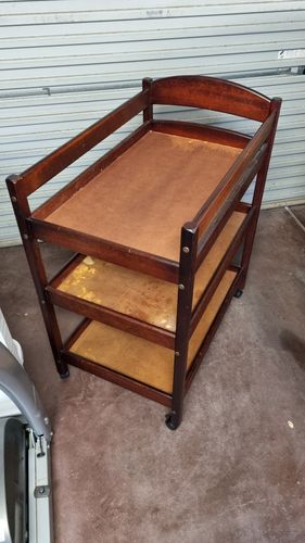

I have an old baby change table that I want to use as a practice run to get into wood working as a hobby. I was thinking of sanding it back, maybe cutting in some grooves for style (I don't expect it to look good), and painting white-ish.
As a newbie, what's the best way to sand this and cut the grooves?
I was considering a ryobi 18+ sander to add to the collection. Guessing I'd need perhaps a work table or vice etc too. Just generally not sure of the tools needed to be safe and efficient, and the order of steps.
It's ok if I ruin the table in the process.

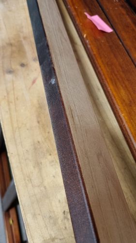

I've gone and got a random orbital sander and progressing through a bit each day. Couple of snags on the sanding I was hoping I might get some advice.
Each piece has a rounded top (and slight rounded corners on the bottom) which seems to be a challenge to sand. Is there any way I can sanded the rounded tops easily with the tool or is this a hand tool task?

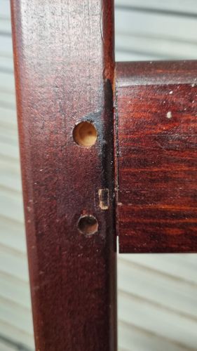

Additionally, turns out while disassembling, the front and rear of the table are glued together and don't come apart by removing screws. What are my options here to separate the pieces without potentially destroying any timber?
Right now I'm just planning on sanding it as is with a bit of manual labour in detail spots.

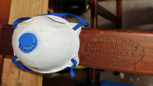

Lastly, I only just noticed there is an engraved logo on the front bottom. Can I sand this down or is there a better way to cover or fill in? (Mask for scale)

Hand sanding the rounded edges is definitely the way to go. As the sandpaper on all powered sanders sits on a flat backing, they are not great for following the contours of rounded surfaces.
The glued sections have more than likely used dowels with glue applied to them. Try putting a chisel in the gap and levering it open. If anything is going to break, it should be the dowels, which can be fairly easily replaced. If you can get it wide enough, you can use a IRWIN 185mm Dovetail Pull Saw in the gap to cut the dowels.
Once the dowels are cut, you'll have to drill them out and replace them with new ones. There are plenty of options for fluted dowels that will work.
Sanding down the logo is the best way to remove it. You could try using a timber filler to fill the recess before staining, but it would likely still show through.
