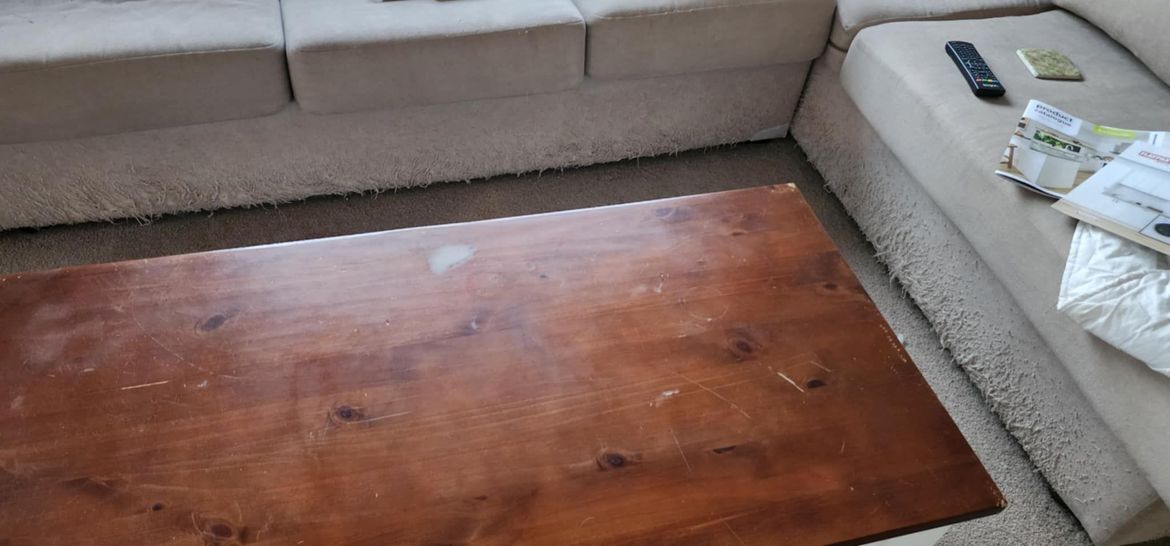

I am in the process of purchasing my first house (currently in pre-settlement still) and I have become inspired to start learning how to use tools so that I can save money and do some cool projects (e.g., painting cupboards, hanging curtains, putting up shelves etc.)! Consider both my knowledge and skills at level 0 for anything tool or DIY related...

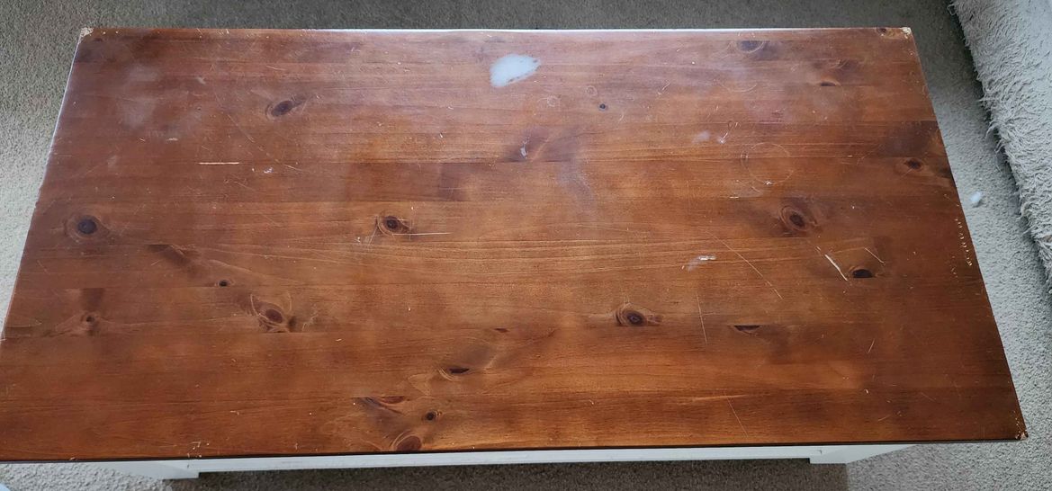

I'd like to start with something small and try to fix my neglected coffee table and couch.
Coffee table:
Couch:
I'm not sure if this is relevant to Bunnings and DIY, but thought I'd ask if anyone has any advice on how I could fix the bottom part of the couch from cat damage. I'd like to see if washing the couch and making the cat damage at least somewhat OK will revamp it a bit.
If anyone sees this and has any advice to offer, thank you in advance! ![]()
Welcome to the Bunnings Workshop community @Kiesie. It's sensational to have you join us, and many thanks for your question about restoring a table and lounge.
The steam and iron method can work if done carefully. Place a damp cloth or tea towel over the stain, then apply the iron on low heat without pressing it directly onto the surface—just hover and let the steam do the work. If the stain persists, a wood touch-up pen or filler can be used for small chips, followed by sanding to make the surface smooth.
If you're using the sander, don't worry—it's a great tool to learn with. Start with a medium grit (like 180), and work your way to a finer grit for a smoother finish. Since you’re new to sanding, take your time, and don’t press too hard. After sanding, apply a wood stain if you want to match the colour, then finish with a clear varnish for protection.
For the couch, using a hair trimmer razor to tackle the cat scratches or any fabric pilling is a great idea. It cuts off the longer lengths and makes the area appear less damaged.
