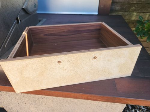

 Hi there, I bought these handles and was hoping to put them as close to the top of the drawer  as possible. I'm worried the timber will split so I intend to use a small drill bit to start with then work my way up to a bigger one.  Do you have any other suggestions? Or are these handles intended to be placed in the centre of the drawer.

Wood type? Any chance of a photo?

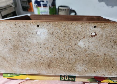

 Thankyou for your suggestions and advice. The timber is only chipboard. I think I will drill the holes before painting so if it does split, I can putty it up and won't have to do a patch up  paint job.

Thankyou Jacob, I was hoping to go a little closer to the edge then 25mm. It's veneer covered chipboard so hopefully the veneer will lower the chances of it splitting. Would reinforcing the back of the drawer further prevent the chances of any splitting?

Your chipboard is a good thickness and looks in good condition, so it will be strong. I don't think there is any real need for reinforcement.
As long as you predrill the chipboard carefully and don't overtighten the screws, you should be fine getting closer to the edge. You'll have to use your discretion, but I am fairly confident you could go as close as 15mm to the edge without issues.
There are always options for patching if things don't go to plan.
