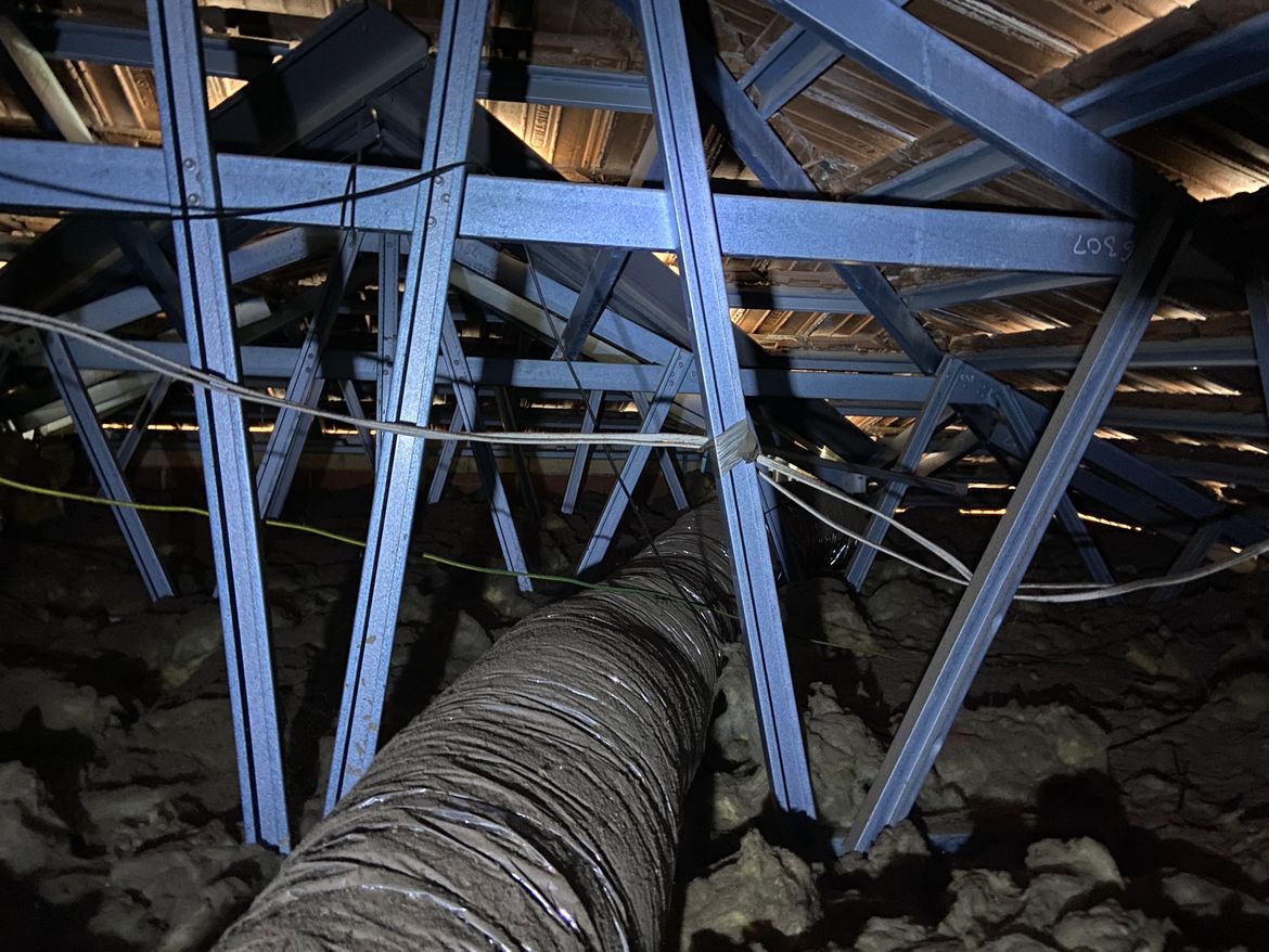

Hi, looking for some advise.
Currently, my kids bedroom are quite hot during summer and I was thinking of adding additional insulation batts in the ceiling for their bedroom.
Just wondering if
1) it is safe to add additional batts on top of existing ones. Currently we already have R4 batts installed from the builder.
2) How much extras can we add?
3) Is there a specific brand/type I should use?
Looking to DIY assuming it's safe to do so. I've been in the roof space in the past due to roof leaks so I'm comfortable doing so.
Thanks in advance.
