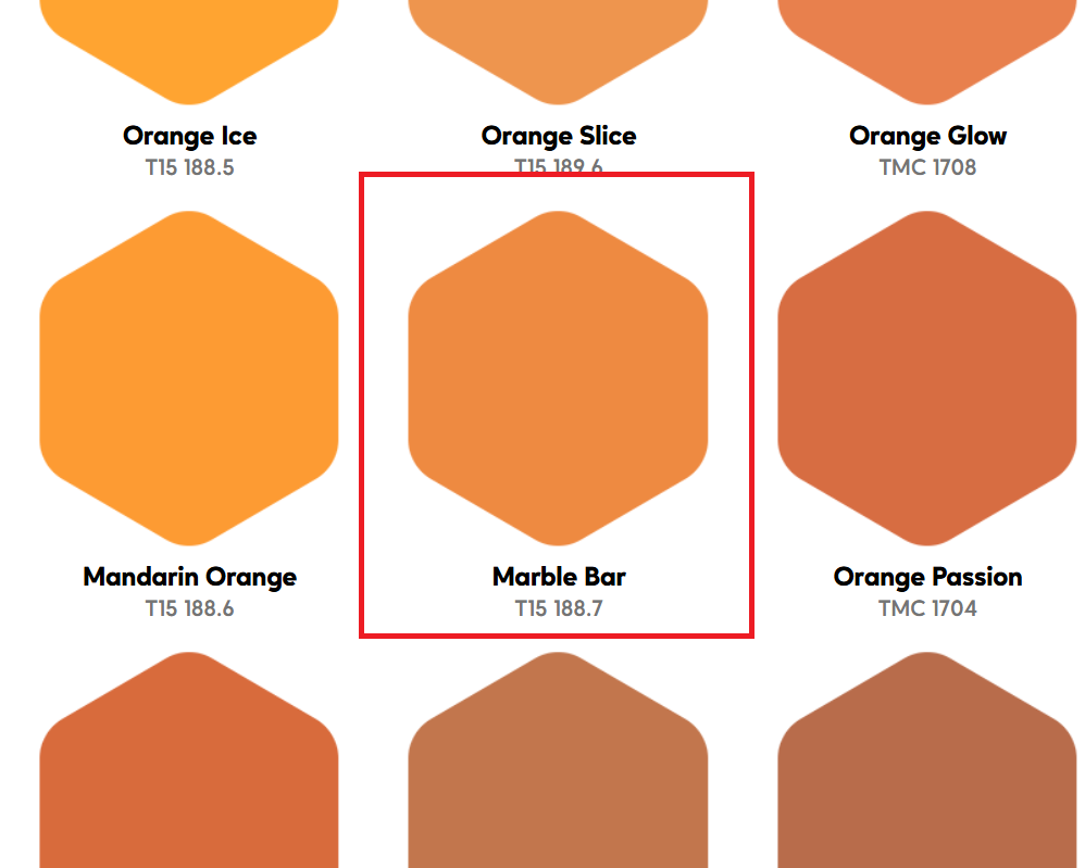

You're correct that we are unable to create vivid orange colours in Dulux Aquanamel as they require an orange base, which we don't have. However, there might be a work-around, and that's to use Taubmans water-based enamel, as some of their oranges use a neutral base, which we do have. For instance, with a quick search, the Marble Bar I've highlighted below can be mixed up for you and applied over the Max Adhesion.
It would be worth spending some time with the team in-store exploring which Taubmans colours are available.

Thanks Mitchell. Most of the paint swatches that I am considering are from the Taubmans range (I’m leaning towards Orange Passion at this stage) but the second in-store Bunnings paint person that I spoke to earlier today said that I couldn’t get those particular colours in a satin or semi gloss.

That might have been a miscommunication about the use of wall paints @Almico. A neutral base in wall paint may not be available in semi-gloss or satin finishes. Typically, wall paints are available in only a low-sheen.
I've confirmed with a store that they can use Taubmans water-based neutral base semi-gloss and mix up Taubmans Orange Passion for you.
I'm a Paint Expert and have spent many years in-store mixing paints. It all checks out to me, and it looks like you can have the colour mixed up. If you can let me know the location of the store you spoke to, I can call them to work it out.
