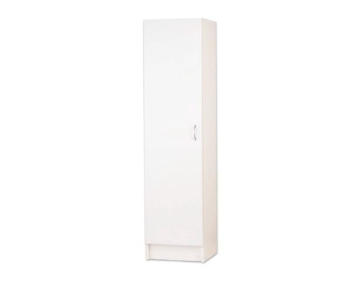

Step 1: Sand all sides to take the shine off the melamine boards and to create a rough surface

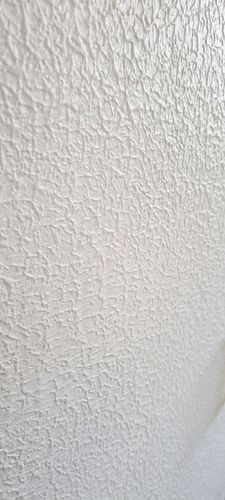

Step 4: use a texture roller to create a pattern.
Previous StepNext Step
Step 5
5/7
Step 5: Once dry stand plaster until smooth and paint with top coat

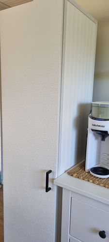

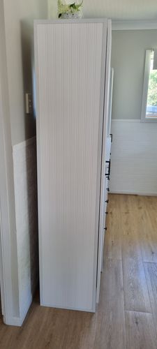

Step 6
6/7
Step 6: for the sides of the cabinets, I used a paintable wallpaper that was embossed. Prime the sides with undercoat of paint and apply wallpaper then paint with topcoat
Step 7
7/7
Step 7: add pvc trim to sides of cabinets to prevent wallpaper from coming off

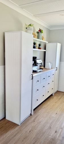

A very classy update indeed @naz1!
You have added some much needed pizazz to your pantry cabinets by using a very cool textured roller technique and painted embossed wallpaper. Was there a particular textured roller you would suggest to someone looking to create this look?
Nice work.
Katie
naz1
Making a Splash
Re: Kitchen pantry cabinet makeover
Thank you 😊
The roller I used is an old roller I already had in my shed. I can't remember where I bought it from, it was so long ago. But I think any texture roller would work
