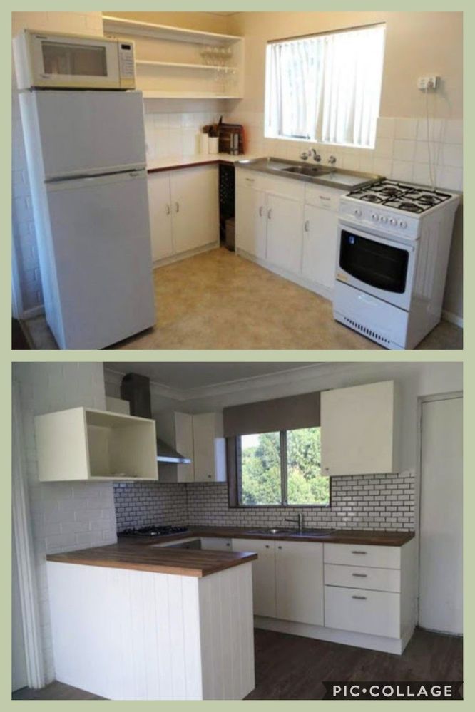

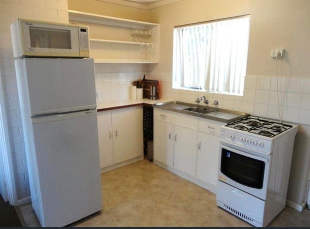

I recently completed a renovation of my in-laws' rental unit. It's a third floor one-bedder and the whole place was starting to look tired, dated and a bit grubby. In particular, the kitchen had very little bench space and a horrible old freestanding gas oven/stove combination.

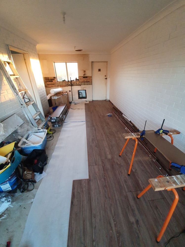

To begin the reno the old lino and carpet was ripped out and I installed a water resistant laminate flooring to the kitchen, living and bedroom areas. This was my second-time installing floating laminate floorboards and I love how easy and quickly they come together.

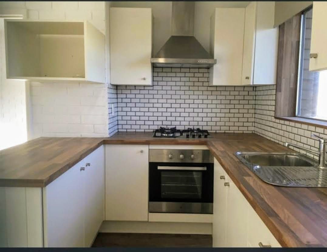

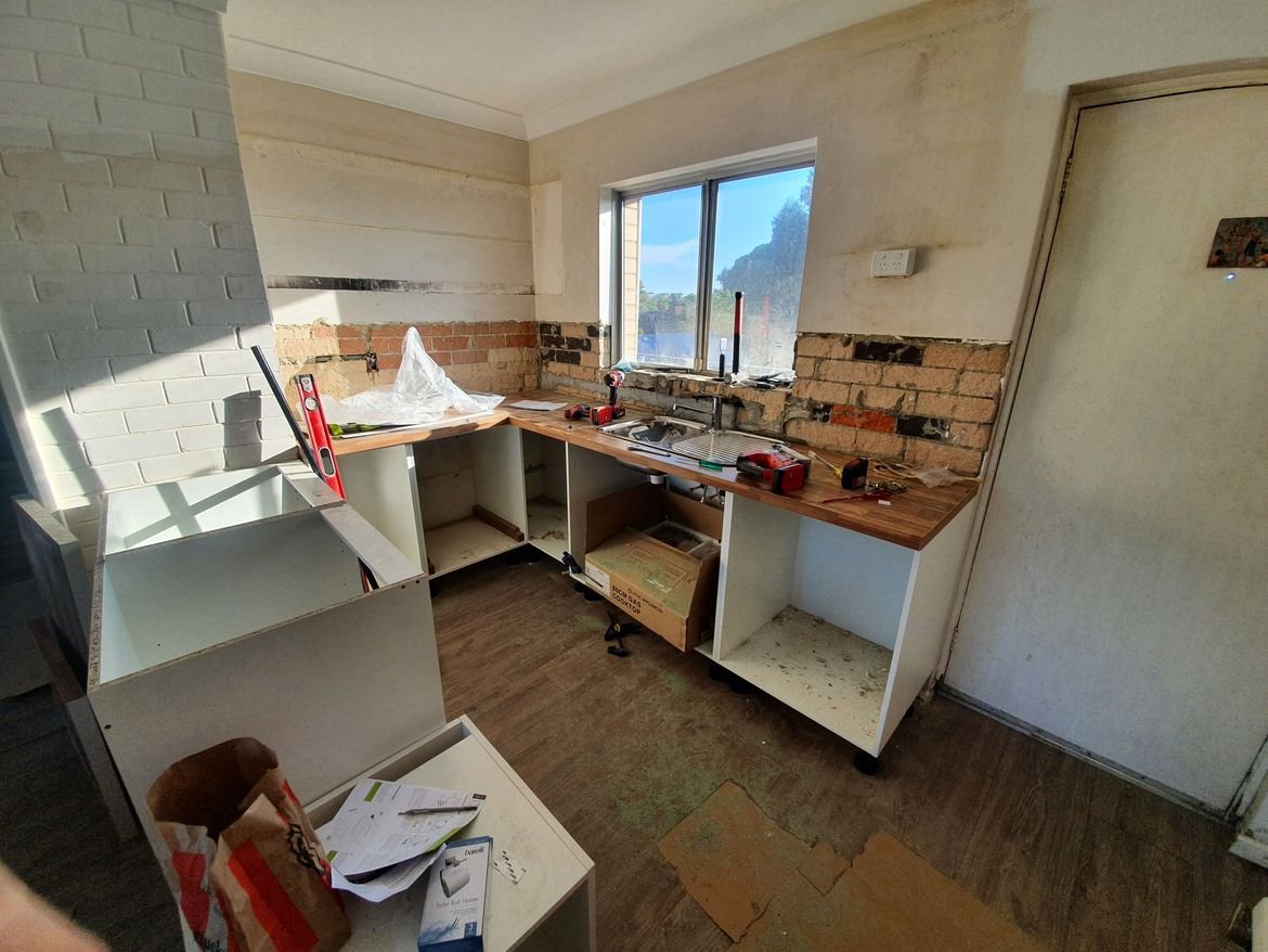

Once the painting and floors were complete, it was time to update the cabinetry. We went for a kaboodle kitchen set up ordered through our local Bunnings. I found that the kaboodle planner tool was pretty easy to use and it allowed us to print a list of all the pieces we needed to order. The cabinets went together reasonably easily, I did have to cut two cabinets down to size with a circular saw as the space I had to work with was slightly smaller than off-the-shelf dimensions would work (I have since realised that kaboodle will make cut to measure cabinets, which I will be trying next time)
Once the cabinets were in I had an electrician and plumber install the oven, stove top and water connections. The final tradie job was to have a tiler retile the splashback with subway-style mosaic tiles and black grout. To match the benchtop I also used a small slotted gum panel to reframe the window sill.

As this project was done around my full time work it took 6 weeks of weekends and after work time to complete the whole unit, but it was a really rewarding experience.

Here is a list of the materials that were used (all sourced from bunnings, isn't it just the best spot for DIY-ing!)
Paint: British Paints Clean and Protect Matt Indoor Paint in Lexicon Quarter
Floating floors: Floor Select 8mm water resistant in Tarragon Walnut
- I used aluminium angle to flash between the ends of the boards and doorways where there were no skirting boards
Subway Tiles: Decor8 Metro White ceramic mosaic
Kitchen Cabinets: all Kaboodle, doors in Provincial White, benchtop in Hickory Maple
Island Bench Panelling: VJ MDF Panels painted with the same colour as walls
Sink: estilo single bowl sink with drainer
Mixer Tap: Dorf WELS 5 Star 6L/min Kip Sink Mixer
