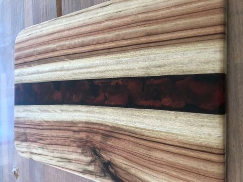

For the new island, I was going to use 2 Specrite project panels and biscuit joint them together but I recently did a resin pouring course (final product in photo) and now I want to use this method to join two pieces of real timber slab together. Any advice on the type of timber to use? Would camphor laurel be ok? The bench top would not have a sink or cooked, would not be used as a chopping board, more for general serving.

Thanks @Jason for tagging me but that's not something I've done. I'd have reservations about using resin to "join two pieces of real timber"--IMO it'd still need some form of mechanical join like biscuits etc & the timber would need to be thoroughly prepared (dried etc) as well as considering any issues with inherent oils. But it could give a very nice result going by @Ang_flange 's photo. Good luck!

I would use timber with a live edge with the bark removed so your resin/epoxy has some imperfections to help it grip. The river effect when you use two live edges facing in and if using a colour to stop bleeding a thin coat of clear around the join and a margin of safety for spills and overflows will give you clean lines when it is finished.
