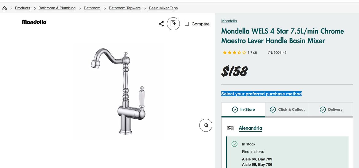

This is about Mondella WELS 4 Star 7.5L/min Chrome Maestro Lever Handle Basin Mixer – see pictures.

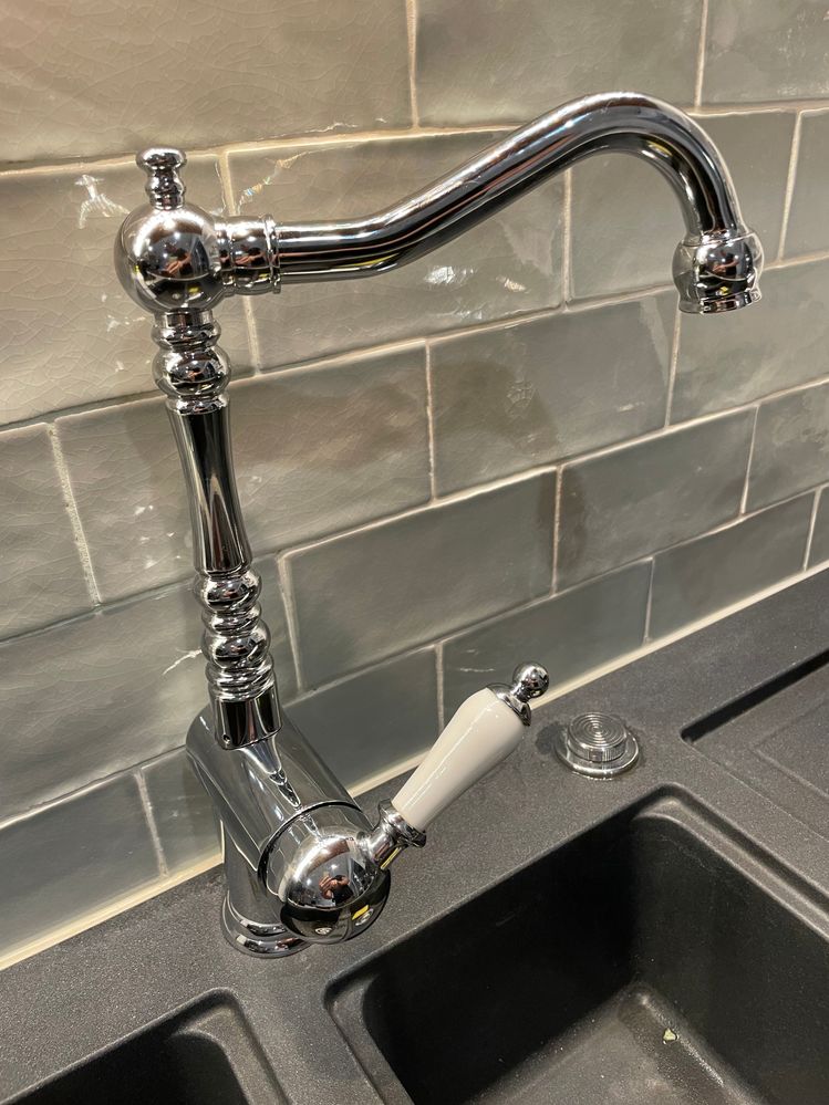

I had this Mondella Mixer installed on my kitchen sick.

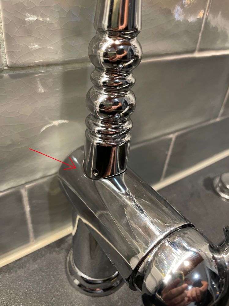

It's been working fine. But after a few weeks, the tap body came loose. There is a screw at the base (refer to other picture with red arrow), but even when tightening it well, the body tap is still loose.

Screw at the base of the tap body

I used the wrong term it seems. This would be the spout that is loose. That is: the part above the grubscrew.
It would tilt a bit when I swivel it. Does it make sense?

I suspect that the rubber washers that support the spout have worn down. This is why you are getting a bit of a lean whenever you tighten up the grub screw.
I suggest using the Syneco 3 - 22mm O Rings Assorted Set along with HydroSeal 40g Tube Tap Lubricant. Failure to put in the lubricant will make it impossible to reinstall the spout and will tear your newly installed o rings.
In order to replace the o rings, I recommend removing the grub screw using an Allen key and pulling out the spout assembly from the main body of the tap. Remove the old o rings and match them up with new ones from the Syneco set. Slide the new o rings on and apply a liberal amount of tap lubricant. Push the spout assembly back on and re-install the grub screw.

I have unscrewed the grub screw but the spout doesn't come out easily from the main body of the tap. I don't want to apply too much strength in case I damage something. Is the spout supposed to pull out easily, or is there another screw somewhere? Is there a diagram describing the components of the tap?

The spout isn't necessarily designed to pull off easily @Freddles. The rubber O rings in there should last for close to a decade, so there's no need for easy access. I suspect that it would just be the grub screw holding the spout on and once it's removed, it would take a bit of force to pull the spout off.

I've had a word with the team at Bunnings Alexandria, and the display does not appear to have the same issue as your tap. Your tap is obviously faulty, and we'd be happy to swap it over for you. The team in-store can check to make sure the new unit doesn't have this issue. However, it sounds from your description that this fault wasn't immediately noticeable.
Changing the tap is likely a job that requires a plumber. We are able to swap the unit over in-store for you, but if you're looking to have someone replace the unit in your home, then it would be best to contact Mondella directly to discuss options.
