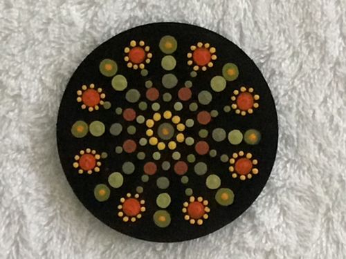

Hello Michael. Many thanks for your help. It has been a while to get back to you as I had to leave the coaster for a few weeks to make sure it was completely dry before spraying. The photo doesn’t do it justice but spraying the coaster really makes the colours pop.
Re: how to seal coasters
If the photo doesn't do it justice, then I'd love to see it in real life @Susanne2! That's absolutely gorgeous! I love the chosen colours, and you should be really proud of your efforts. It looks sensational.
