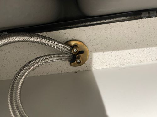

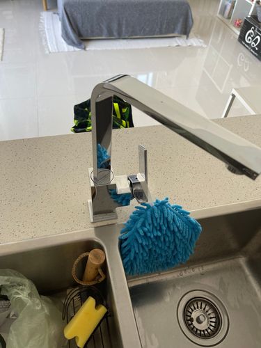

hi, I going replace my kitchen faucet. Please advise how do I disconnect the water supply before installing the new faucet.

To disconnect the water supply before installing your new kitchen faucet, start by clearing the area under the sink, locate the hot and cold water supply lines connected to the faucet, and turn off the corresponding valves by rotating them clockwise. Open the faucet to release any remaining pressure, then use pliers or an adjustable wrench to disconnect the supply lines, catching any drips with a bucket or towels. Inspect for leaks or damage, proceed with faucet installation, and after completion, turn the water supply valves counterclockwise to restore water flow, testing for leaks. If any issues arise or if you're uncertain, consider turning off the main water supply to ensure a smooth faucet replacement process.
Please be advised that this could be considered plumbing work and might require a licensed plumber depending on your location.
