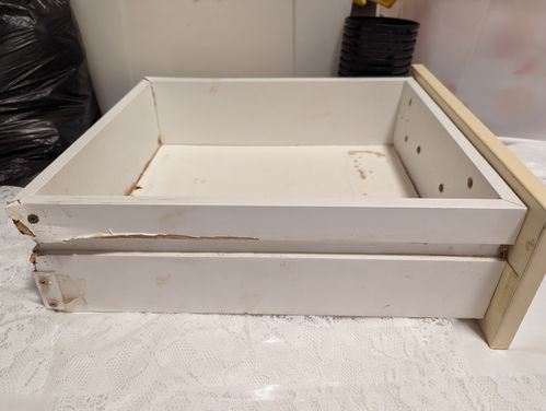

Example of one of the drawers

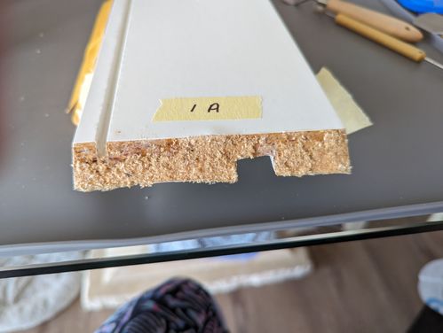

Example of a side panel when drawer is dismantled

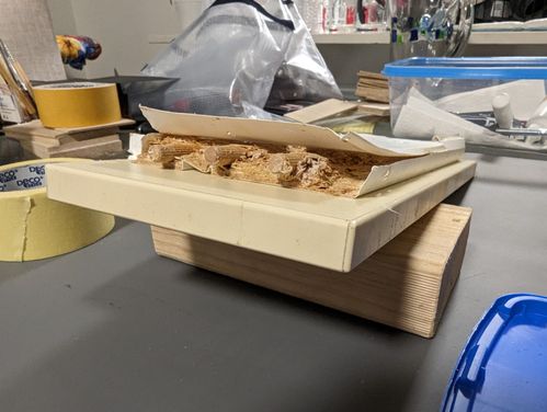

Example of digging out damaged chipboard

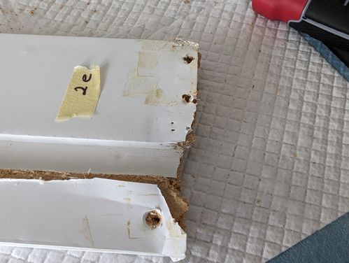

Example of refilling with sawdust and glue (not yet sanded)
Hello. This is my first ever post. We have purchased a unit and the kitchen needs a lot of work. Before we rip parts out and replace, I want to have a crack at repairing. My only expertise is from google haha. As you can see, the kitchen drawers are in very bad shape. They are chipboard, water damaged in places and the vinyl wrap is cracking everywhere. As far as the chipboard itself, I have been having fun digging out the damaged parts and refilling with sawdust mixed with glue (Like a tooth filling haha). The last picture is what a drawers side looks like when refilled. I haven't sanded it yet as it is still drying.
My actual question is what to do with the vinyl wrap. I'm wondering if I can remove it all, sand the bare chipboard smooth, prime, paint and waterproof it and leave the drawer bare like that without vinyl wrap?

Welcome to the Bunnings Workshop community @Gloellas. It's great to have you join us, and many thanks for your question about repairing chipboard drawers.
Your method appears to be working, and I haven't actually seen someone attempt a repair on swollen chipboard that's this damaged before, so good on you. My only concern is that by removing the vinyl wrap, you could compromise the structural integrity of the timber if it's only being held together by the wrap. If the timber feels quite solid, removing the wrap is possible. The Dulux primer you have would be suitable, but if the chipboard is not exceptionally smooth, you might need to do at least a couple of coats to get a good finish.
