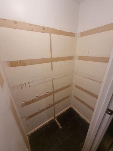

Hey @MitchellMc & @EricL,
So, I gave it a go and actually managed to get the slate tiles up pretty easily. Many of them came up in one piece once I'd loosened the tile around them.
My next job is to continue to remove the tiling cement that was used!
Is it the same process, using the same tools, or is there something different for this portion of the job?
Image hopefully helpful!
