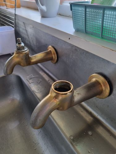

I presume you want to remove the entire tap body from the splashback. To do so, you'd take a pipe wrench and grip the tap body where the spindle screwed in and then turn the tap body anti-clockwise. Alternatively, you might be able to stick a large screwdriver in the spout or in the spindle hole and use it as a lever to turn the body.

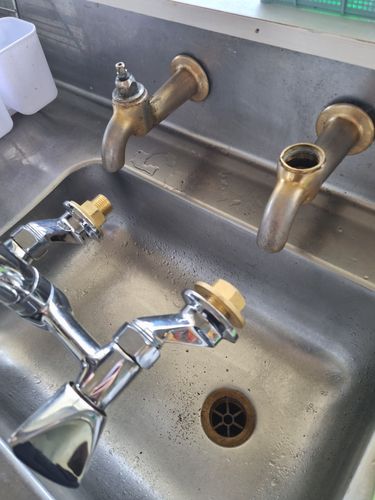

Thanks for your help Mitchell, follow up question. Can this tap be installed here or do I have the wrong thing?
Re: How to remove old kitchen taps
Possibly @Tjohnson. It will depend on whether the threads are male or female on the wall. If they are female, that should work, but I don't think it will be possible if they are male. That style of tap is designed to go on a thin wall and have female adaptors screwed onto it's threaded sections.
The copper-coloured nut will unscrew off your new tap, but can you tell if the male copper thread can be removed as well? If it was just the chrome portion without the copper thread, then that should screw directly onto what I presume will be male threads coming out of the wall.
